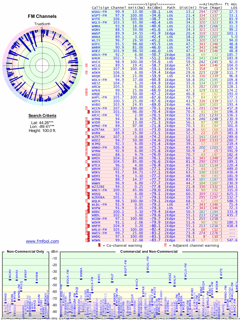

Two amplifiers in the same system will add noise and distortion unnecessarily, I'd opt for a single pre-amp, such as the Antennas Direct CPA-19.
An FM trap may be needed.
