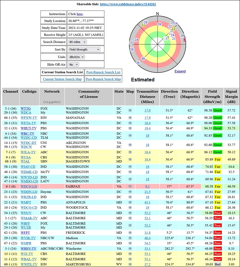

rabbit73 2-Nov-2023 11:43 PM
2 Attachment(s)
Originally Posted by estcstm3 (Post 63851)
Hi all - just moved. Would like to pick up the main abc,nbc,cbs,fox,cw,pbs. This is for a main level tv. Do you have antenna reccomendation? Can I get away with one that "sticks" behind the tv itself? My wife doesnt want to see it in the room. Otherwise I can run from the attic. thoughts?
Hello, estcstm3
Here is a signal report from rabbitears.info based on an estimate of your location:
https://www.rabbitears.info/searchma...udy_id=1144261
https://forum.tvfool.com/attachment....1&d=1698971510
You can do a more exact report here (I use coordinates):
WHUT is the light house channel for the new ATSC 3.0 broadcast standard:
https://www.rabbitears.info/market.p...=27772#station
You can click on other channels to see the subchannels.
