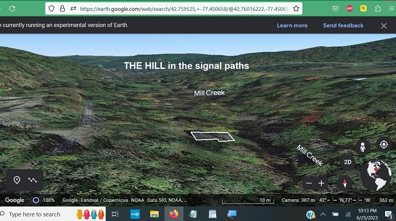

Yes, the signals have to bend down from the crest of the hill to your location, so your reception will never be 100% reliable. You are at the mercy of atmospheric conditions.
Your HILL:
https://forum.tvfool.com/attachment....7&d=1687887532

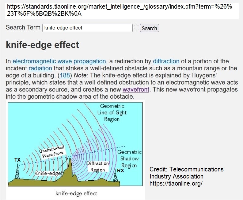

The knife-edge effect scatters the signals at the crest of the hill:
https://standards.tiaonline.org/mark...5F%5BQB%2BK%0A
https://forum.tvfool.com/attachment....8&d=1687887895

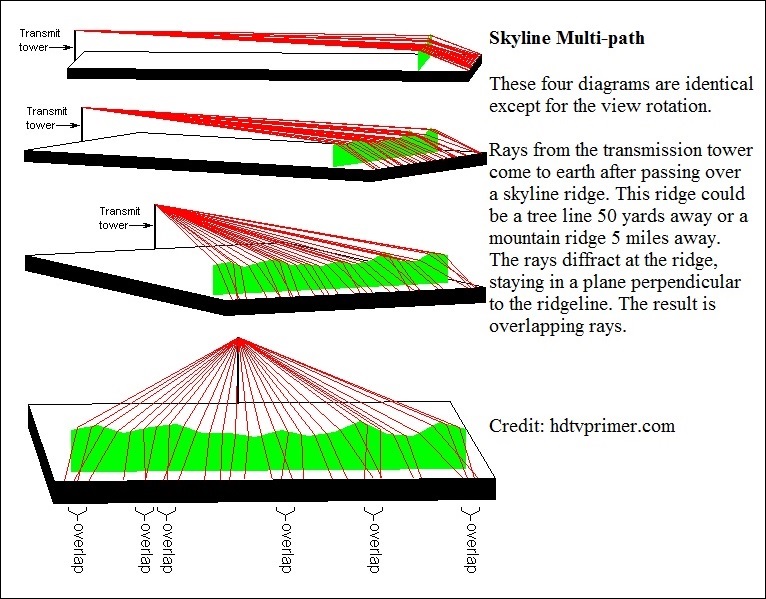

This shows the scattering:
https://forum.tvfool.com/attachment....4&d=1687978694
which creates overlapping fields:
https://forum.tvfool.com/attachment....6&d=1687990318

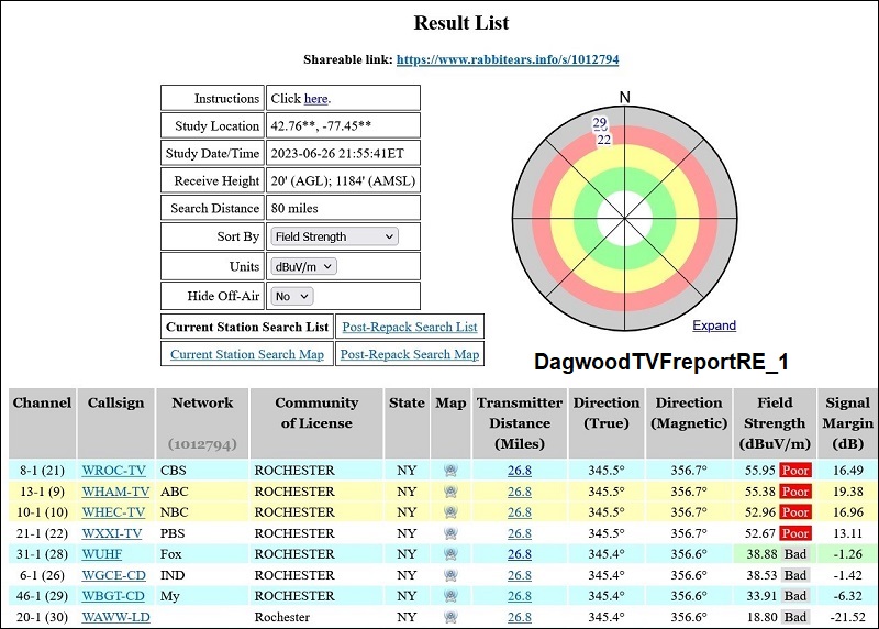

This is the rabbitears.info signal report for your location:
https://rabbitears.info/searchmap.ph...udy_id=1012794
Extract from report:
https://forum.tvfool.com/attachment....9&d=1687890837

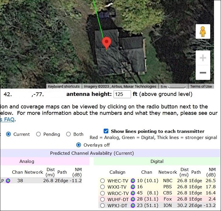

Using outdated TVFool data, I tried different antenna heights:
https://forum.tvfool.com/attachment....1&d=1687895038
https://forum.tvfool.com/attachment....2&d=1687895644
https://forum.tvfool.com/attachment....3&d=1687896113

If the antenna is behind a tree, it is in overlapping fields: a weak field that passes through the tree plus a weak field that is diffracted around the tree. Overlapping fields are complicated, with strong spots and weak spots. This will be true even if the tree is not a perfect sphere. If you get a UHF antenna to work behind a tree, you will likely see dropouts when the wind blows because the strong and weak spots will move around as the tree deforms. Even in a good-signal neighborhood it is inadvisable to put a UHF antenna behind a tree.
The farther away a tree is, the less of a problem it is. For far away trees, assume no signal penetrates the tree, and reception will be by diffraction around the tree. Trees block 100% of satellite signals.

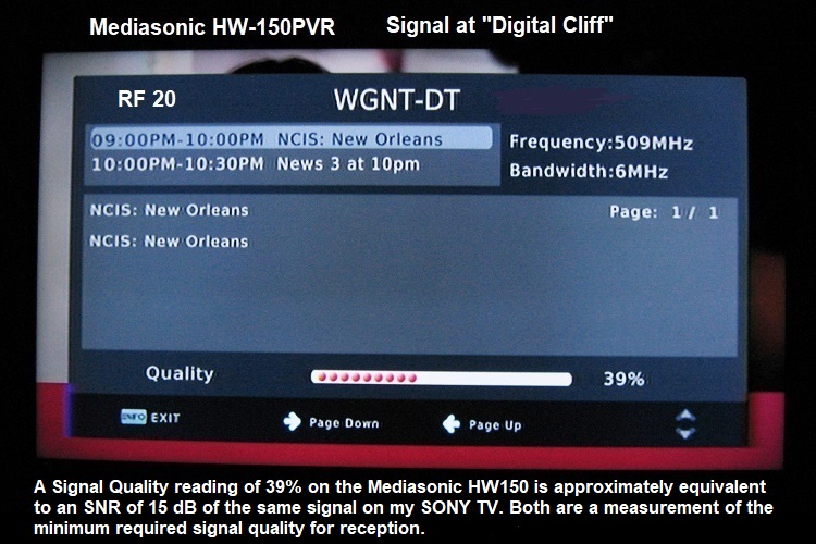

rabbit73 8-Jul-2023 3:04 AM
2 Attachment(s)
Originally Posted by Dagwood (Post 63832)
Signal direction: Yes, apparently so. Just standing on the ground and holding my iPhone up, the antenna is now pointing about 12? to the east, off of due north.
From memory, it was probably at least that much to the west off of due north before, so quite a big shift of at least 24?.
I checked those links and Googled the model numbers you showed but I'm not sure what I'm looking at. They keep showing a "tuner." I assumed this was some kind of handheld gadget to find the strongest signal. :confused:
Yes it is a converter box/tuner. Tyler uses this one:
https://www.amazon.com/Mediasonic-HO...780923&sr=8-12
I use one like this:
https://www.amazon.com/Mediasonic-Co...8781378&sr=8-4
The screen looks like this when you plug the tuner into the HDMI input of your TV:
https://forum.tvfool.com/attachment....8&d=1688781855
https://forum.tvfool.com/attachment....9&d=1688782726
Please watch this Video:
https://www.youtube.com/watch?v=YDQzvFG3chs
See also:
TV Antenna Signal Meters - Improve Your Reception with One
https://www.youtube.com/watch?v=1_Cy08x5qeY
