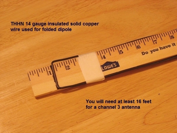

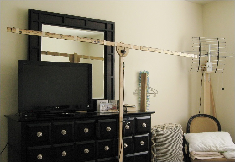

Here is an indoor folded dipole I made for Channel 3:
https://forum.tvfool.com/attachment....9&d=1635340619
https://forum.tvfool.com/attachment....0&d=1635340975
