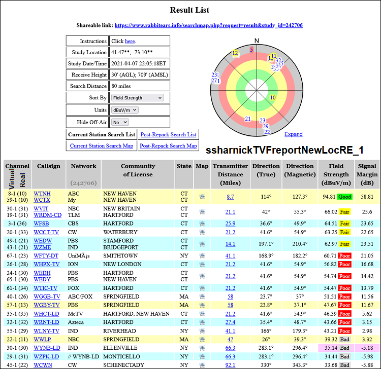

My question is do you think if I point the antenna toward the UHF towers I want to receive (WFSB, WVIT...) will the VHF elements pick up the VHF station (WTNH) that I want from the side. The location is below.
Thank you for any input.
Shawn
http://www.tvfool.com/?option=com_wr...9038b22ad35481

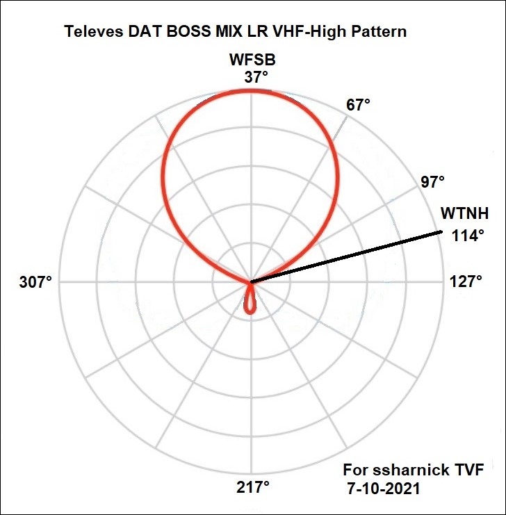

Hello, Shawn.
That's difficult to predict. WTNH will be in a null, making it a lot weaker, when the antenna is aimed at WFSB, but it will help that WTNH is much stronger.
You might have some multipath reflections that will interfere with the reception of WTNH when the antenna is not aimed at WTNH.
You will just have to try it.
https://www.rabbitears.info/searchma...tudy_id=242706
https://forum.tvfool.com/attachment....3&d=1625943227
If it doesn't work, you will need to use separate UHF and VHF antennas combined with a UVSJ.

That antenna is much larger than necessary for your location. It covers UHF, VHF-High, and VHF-Low. The VHF-Low elements are 110" wide. You don't have any VHF-Low channels (Real RF channels 2-6).
https://www.solidsignal.com/Manuals/HD8200XL_Specs.pdf
https://forum.tvfool.com/attachment....9&d=1627868201
