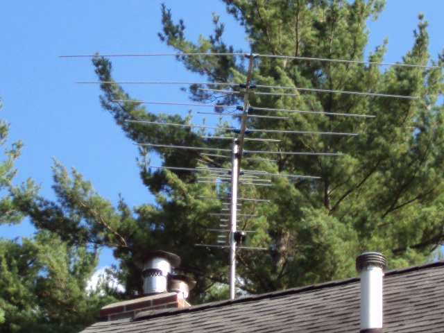

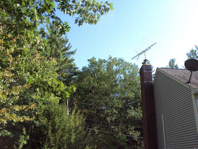

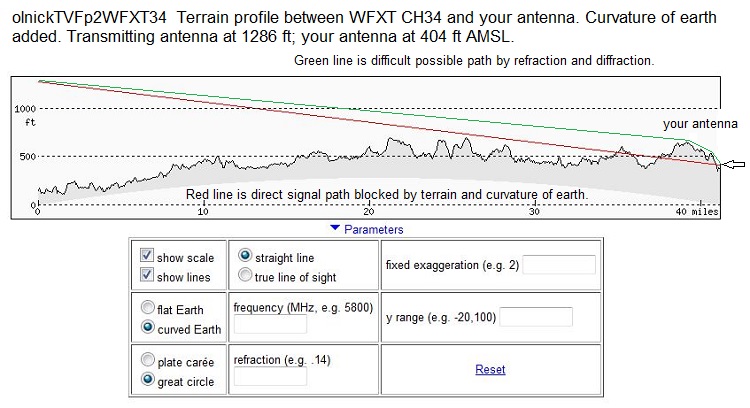

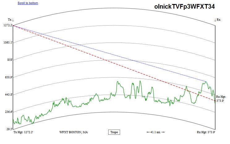

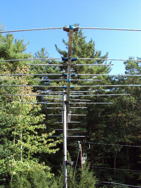

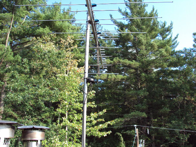

WFXT Fox will be difficult for you to receive.
You have two strikes against you: the hill in the signal path and the trees.
You might have half a chance if you can get your antenna above the trees.
That would require a tower or a tall push-up mast with guy wires.
http://forum.tvfool.com/attachment.p...9&d=1441831482
http://forum.tvfool.com/attachment.p...0&d=1441831494
http://forum.tvfool.com/attachment.p...1&d=1441831504
http://forum.tvfool.com/attachment.p...2&d=1441831514
