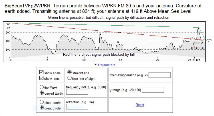

rabbit73 26-Aug-2020 11:04 PM
4 Attachment(s)
Originally Posted by BigBean (Post 63150)
Finally, I'm looking to grab WPKN out of Trumbull, which is a small
10kw station. I may grab a few others along the way, who knows.
I get it now on my MX117 tuner but it's weak.
This is what the WPKN-FM transmitter site looks like:
http://forum.tvfool.com/attachment.p...5&d=1598479070
This is the coverage area for WPKN:
http://forum.tvfool.com/attachment.p...6&d=1598479123
That ridge to the west is a good chunk of the problem.
Very true; it blocks the direct signal:
http://forum.tvfool.com/attachment.p...7&d=1598479196
http://forum.tvfool.com/attachment.p...8&d=1598479243
BigBean 28-Aug-2020 4:33 PM
WOW Thanks, Rabbit! Is that Google Earth? I haven't used it in awhile.
Yeah, that looks like the SECOND ridge, as we're in a little valley. There's
a hill across the street to the West, then beyond TriMountain that higher
ridge. I've heard folks who live atop it can receive NYC and I believe it.
The thing that kills me is, once again, tech has passed me by. I remember
