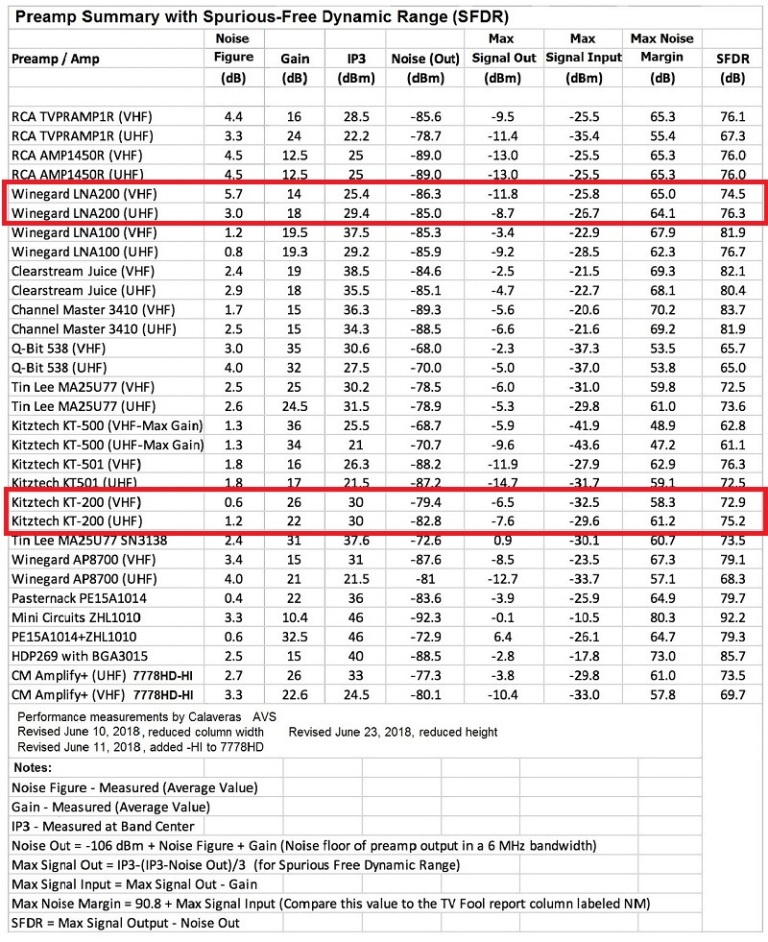

After talking myself out of it several times, simply because I already had a "Low Noise" Winegard LN-200 and a couple of RCA preamps. I felt I wanted to see what the hype was. Well, it's not bragging if you can back it up! I saw this chart by a well known RF enthusiast, Calaveras.
http://forum.tvfool.com/attachment.p...1&d=1586904198

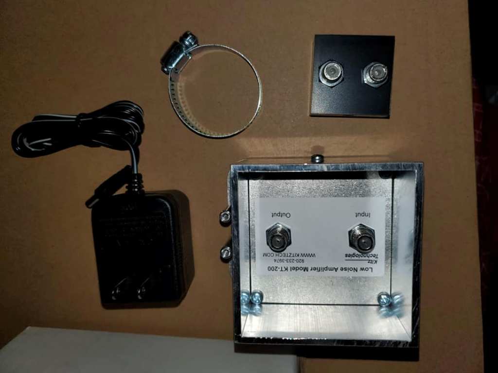

KT-200 Kit:
http://forum.tvfool.com/attachment.p...1&d=1586903104

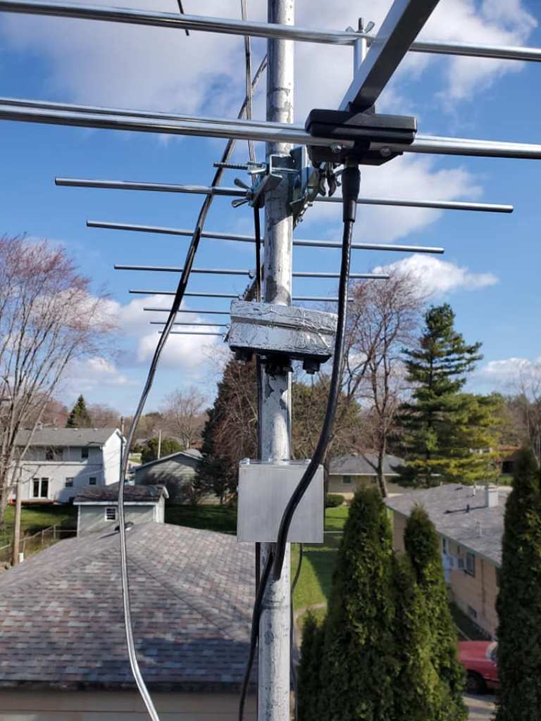

I hooked up my stock 30-2476. I tested VHF only today, it was very cold and windy on the roof:

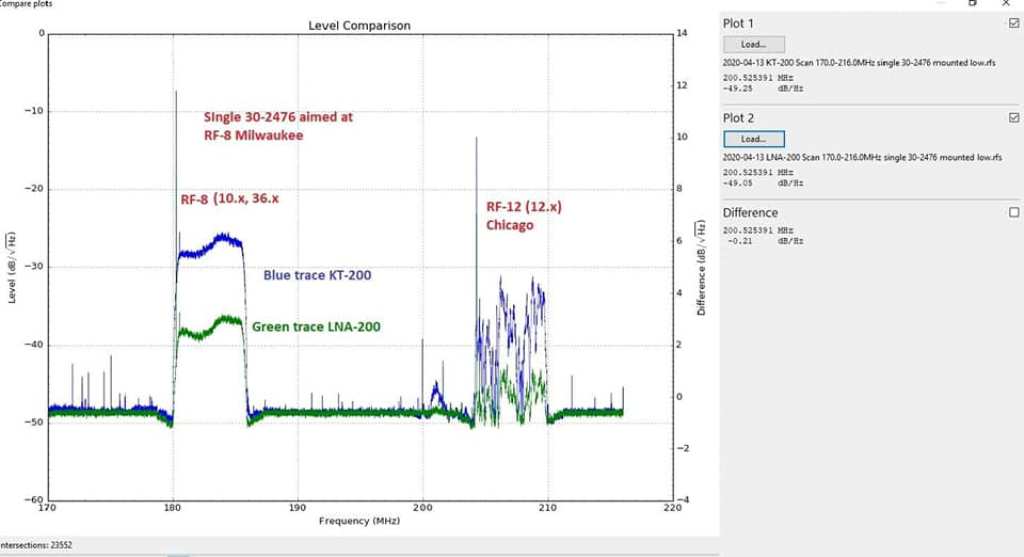

After some base line testing, I did a comparative spectrograph:

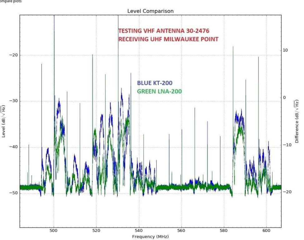

For fun, I looked at the UHF capabilities of the 30-2476. Most of those stations are actually watchable, even some coming from the rear of the antenna:
I hope I gave the LNA-200 a fair shake. I went back an hour later after leaving the LNA-200 unplugged and retested. The results were the same.
