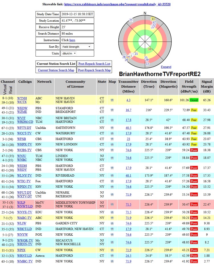

Hello, Brian. Thank you for the report. You do have co-channel interference, but it is now different because of Repack channel changes.
WFSB has co-channel interference on real channel 36 from WCBS also on 36. WFSB is only about 4 dB stronger than WCBS; it needs to be at least 16 dB stronger. However, since WCBS is in the opposite direction, a high gain directional UHF antenna with a good Front to Back ratio should make WCBS weaker.
This report from rabbitears.info is probably more up to date:
https://www.rabbitears.info/searchma...study_id=35520
This is an extract from that report:
https://forum.tvfool.com/attachment....5&d=1576456127

GroundUrMast 16-Dec-2019 3:59 AM
My previous estimate of your location may be inadequate... It would be helpful if you could generate a signal prediction using the search tool at rabbitears.info, https://www.rabbitears.info/searchmap.php
BrianHawthorne 16-Dec-2019 11:07 PM
Thanks
GroundUrMast, Rabbit73,
Gentlemen thanks for the in depth information. I plan to start with the aluminum foil trick, to see what happens, and take it from there.
GroundUrMast,
I ran my lat-long through rabbit ears, here’s the link
https://www.rabbitears.info/searchma...study_id=35895
Thanks again,
BrianH
GroundUrMast 17-Dec-2019 2:27 PM
Thanks for posting the additional prediction... My estimate of you position was off target apparently. It looks as if rabbit73 did a better job. Please keep us informed on your progress.
