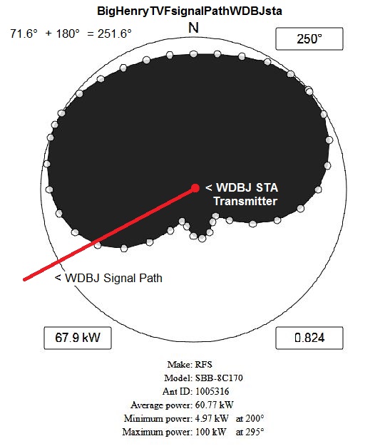

rabbit73 6-Dec-2019 11:45 PM
1 Attachment(s)
Originally Posted by BigHenry (Post 62483)
I have a Channel Master CM-5020 antenna which connects to the balun and then directly to the tv. The antenna is only about 18 months old. In that short time I have had to replace the built-in balun with a CM-94444. It looks like that balun too is failing because I have the same symptoms of intermittent, random loss of channels.
Here is my TVFool report:
http://www.tvfool.com/?option=com_wr...9038f3360d6a26
Hello, BigHenry; welcome to the forum.
Thank you for the signal report. Here is a report based on your exact address instead of your zip code from rabbitears.info:
https://www.rabbitears.info/searchma...study_id=33265
This image is an extract from that report:
https://forum.tvfool.com/attachment....7&d=1575676969

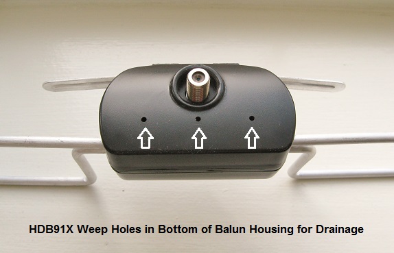

There are two types of printed circuit board baluns. A UHF printed circuit board balun is only good for UHF.
https://i.imgur.com/q8jSCXc.jpg
There is a type of circuit board balun thay is good for all three TV bands because it has a ferrite core balun mounted on the board. You will only find this only on Winegard antennas.
https://i.imgur.com/mN07nXU.jpg
https://i.imgur.com/WEqjATF.jpg

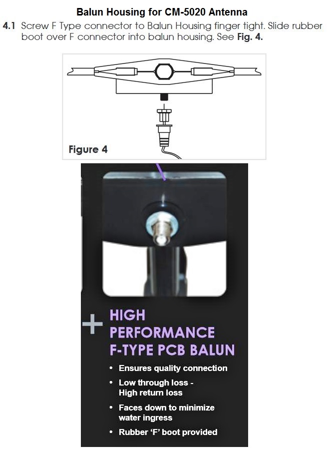

I really don't know what is inside the CM-5020 balun; can you show us the inside of the one you removed?
https://forum.tvfool.com/attachment....8&d=1575681045

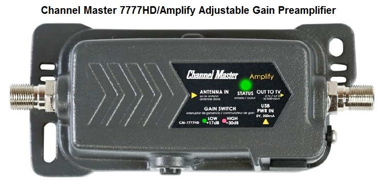

rabbit73, for your suggestion of a pre-amp, would the Channel Master CM-7777HD be a good choice?
To your question on what's inside the CM-5020 balun, unfortunately I tossed it last August without looking inside.
rabbit73 7-Dec-2019 1:38 AM
3 Attachment(s)

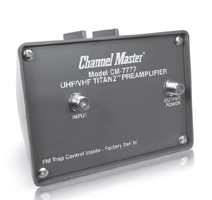

The CM7777HD is a good preamp; I have two of them that I use as test amps for setups. But, I really don't like the housing because it doesn't seem suitable for outdoor use. Their other preamps have the connectors on the bottom which provides better weather protection.
https://forum.tvfool.com/attachment....0&d=1575730865
Their previous 7777 with the single antenna input doesn't have a good reliability record:
https://forum.tvfool.com/attachment....2&d=1575732193

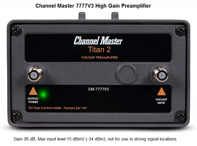

Their new 7777V3 looks promising, but it is as yet unproven. I suspect it will be more reliable.
https://www.channelmaster.com/TV_Ant.../cm-7777v3.htm
https://forum.tvfool.com/attachment....3&d=1575734997
