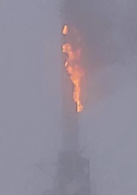

I'm not sure if this is the right place to post this, but I thought it would be interesting to discuss among us all...
In the Burlington, Vermont market, the WCAX (CBS) and WPTZ (NBC) transmitter tower caught fire last week and as a result, I am currently without these two networks. Bad timing for me, since it is right in the middle of NFL football season. Here is a link to an article describing the situation:
https://www.tvtechnology.com/news/to...tz-off-the-air
And here is a picture of the fire:
http://forum.tvfool.com/attachment.p...1&d=1574697064
Within three days, both stations restored service to subscription-based cable and satellite providers, I believe by putting up a temporary truck-based transmitter with enough power to be received by those companies for redistribution. But their full-power OTA broadcast is a different story. I called the stations and they currently have "no idea" how long it will be before OTA is restored and would not even take a guess at a timeline.
So my questions for forum discussion are:
1) Assuming the transmitters are completely destroyed, how long do you think it will take to replace them?
2) How long if both the transmitters and the tower itself are destroyed?
Note that the tower is on top of Mount Mansfield and the only way up there this time of year is by Snowcat (ski-slope groomer). Conditions up there are very difficult to work in, with high winds (often 70+ mph) and fog/icing conditions dominating at this time of year.
3) Also, have any of our more experienced forum members ever seen anything like this? I wonder if the fire had anything to do with WCAX's recent re-pack-related move from RF-22 to RF-20, for which I don't think they installed new transmitter hardware. I could be wrong, but I think since the new frequency was so close, they just decided to drive their existing hardware at the new lower frequency. If so, could that have caused unexpected heating that led to the fire?

Tower Guy 25-Nov-2019 9:04 PM
Unfortunately you live in a weak signal area for WCAX. I think that they need to be at full power for you to receive them.
The antenna fire covers a good portion of the antenna itself. The repair is likely to be more extensive than the article infers. The antenna is built using 40 panels wrapped around a square spire and covered with a fiberglass radome. Obviously, the radome is heavily damaged. You can assume that a problem on one or more of the 40 panels caused the fire. It is likely that the coax going to some of the panels have melted and will need to be replaced.
In order to get back on the air a temporary antenna may be used, but it won’t have as much gain as the main antenna, and may not be able to handle all the power the transmitter can make. Another approach to getting back on the air is to use the lower half of the existing antenna using panels salvaged from the side that didn’t burn.
Hopefully the transmitters sensed a problem on the antenna and shut down before they self destructed.
I also wonder if the repack was a part of the failure, but it’s also possible that the fire was due to significant ice buildup on the antenna and the new transmitters didn’t turn the power down to compensate for the excess ice.
