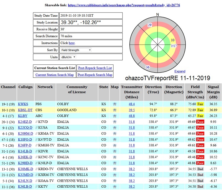

Here are my reports:
Note I do have a full power FM station about 1/2 mi south.
http://www.tvfool.com/?option=com_wr...90388d28ae2280
https://www.rabbitears.info/searchma...study_id=26776
Hope someone has some thoughts... thanks!!!

Hello, ohazco. Thank you for the reports.
It sounds like the new tower location isn't quite as good as the chimney location was for reception.
I have not received Denver channels reliably (>20% of the time) for about the last year and have just had it pointed east.
You are not receiving channels from Denver, you are receiving channels from low power translators in Idalia that carry Denver channels.
https://forum.tvfool.com/attachment....7&d=1573527393
https://forum.tvfool.com/attachment....2&d=1573522871
https://forum.tvfool.com/attachment....3&d=1573522932
Denver channels would never make it to your location except during unusual atmospheric conditions.
https://forum.tvfool.com/attachment....4&d=1573523050
Something might be in the signal path from Idalia that wasn't there before, like trees.
Channel 10 has started to get choppy.
Channel 10 is a VHF channel; the 91XG isn't designed to receive VHF channels and its balun doesn't pass VHF channels.
This weekend I decided to try a new 91XG and a Winegard Boost XT preamp (instead of the RCA) and completely rewired, to try to get my Denver channel back. I think it got worse.
You are on the extreme fringe outside the area of coverage for Idalia channels. The red marker is your location.
https://forum.tvfool.com/attachment....5&d=1573525178
K24EZ is a low power translator only running 0.192 kW ERP, that's 192 Watts. The actual transmitter output is only 20 Watts with an antenna gain of 8.06 dB.
0.03 kW TPO + 8.06 dB gain = 0.192 kW ERP
https://www.rabbitears.info/tvq.php?...ms&facid=55618
I get vhf10 very choppy only when pointed northeast, and get 17 and 19 only when pointed due east with occasional choppiness. I just can't figure out what gives and am at a loss.
The 91XG receives VHF channels off-axis.
I am considering an HDB8X to try... but am very hesitant to keep throwing money at this.. I just wasted $100+ on a new 91XG, and also concerned about its wind load, not sure my tower could take it.
The 91XG is a better choice for your UHF channels.
I wired up the elderly neighbor next door with his 30 year old UHF antenna and no preamp and he gets Kansas most the time.
?@%@X!
Small changes in location can make a big difference in reception.

Rabbit, attached is my FM fool report.
I knew they were from Idalia repeaters, just meant the channels were Denver channels. My county is the only county in eastern CO that turned their repeaters off in 2007. :(.
I forgot about the terrain model/map... In 2012 I was definately in a more solid band of the Idalia transmitter.. I wonder if they lowered the power or something. I theorized tree growth as well... but just found it too coincidental that I also progressively lost Kansas channels.

I spent a lot of time reviewing your situation.
Realistically, you should have no problems with
the Kansas stations. KWKS runs 464kw with an
antenna height of 373m agl. KLBY runs 625kw
but the antenna is 219m agl. The issue with KBSL
pixelating is probably related to the 91XG antenna,
that is not designed to receive VHF. The other
two stations should not be causing you any concern.
This leads me to believe you do have some issue
with your system. How close/tall are the closest trees
and in what direction are they???
Thank you for the FM report. I see one strong FM transmitter KNAB coming from the south with a signal power of -15.1 dBm. If your antenna is aimed north or east, that will reduce the possibility of FM interference. If you do have FM interference it is most likely to be on VHF channels and a filter would help.
How unfortunate; I was wondering why you didn't have stronger signals.
Other than that... sounds like I just need to give up on the Idalia/Denver channels.
All is not lost. With a few modifications you can still have some reasonable reception.
