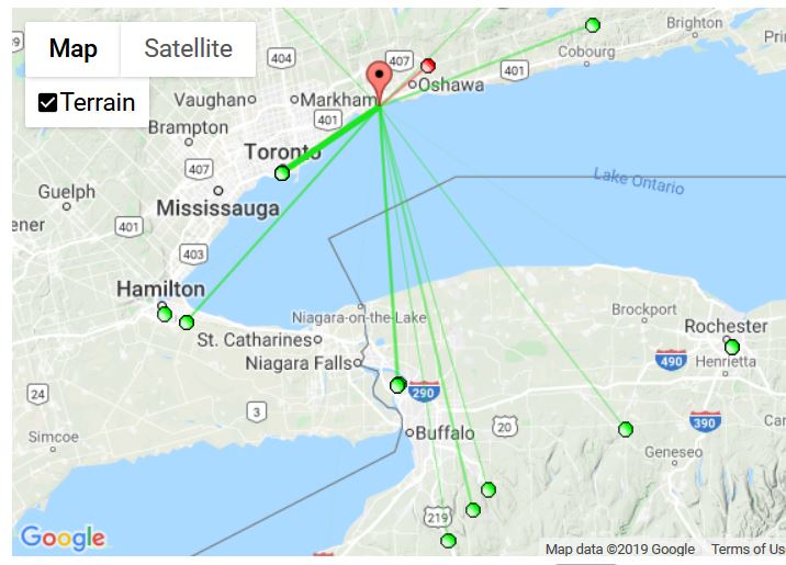

rabbit73 17-Oct-2019 8:39 PM
3 Attachment(s)
https://forum.tvfool.com/attachment....1&d=1571358639
Originally Posted by BrooklinOTA (Post 62320)
Here is my TV Fool report if it helps: http://www.tvfool.com/?option=com_wr...9038b49f8b2436
https://forum.tvfool.com/attachment....2&d=1571358893

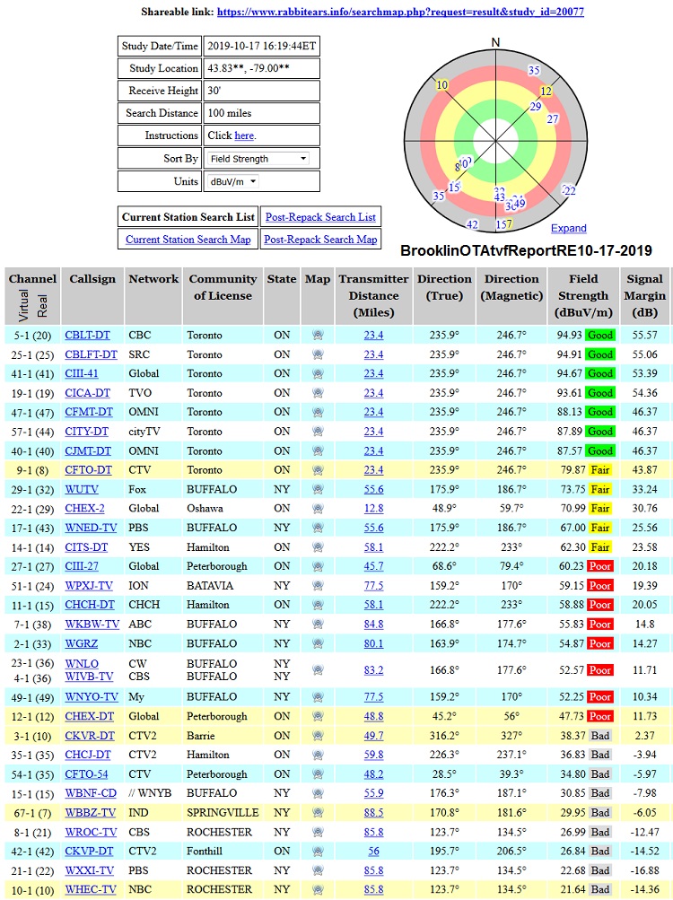

Thank you for the TVFool report. Here is a rabbitears.info report based on my estimate of your location. It should have a more accurate list of channels.
https://www.rabbitears.info/searchma...study_id=20077
You can do your own report here. You might need to use coordinates.
Extract from rabbitears.info report:
https://forum.tvfool.com/attachment....3&d=1571360017
