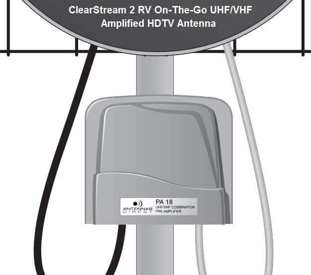

rabbit73 6-Oct-2019 1:44 AM
2 Attachment(s)
Originally Posted by phone man (Post 62285)
The pre amp looks a lot like the PA-18, is it ?
It looks like the PA-18 in the instructions:
https://forum.tvfool.com/attachment....7&d=1570322637
They don't show the power inserter in the antenna description, the antenna instructions, or the video, but they do mention to connect the power in the video.
https://forum.tvfool.com/attachment....8&d=1570324637

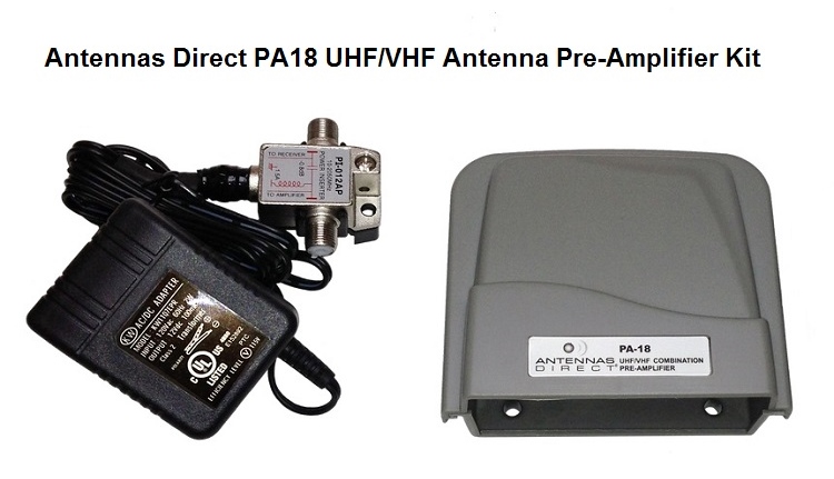

rabbit73 6-Oct-2019 4:01 PM
1 Attachment(s)
Originally Posted by phone man (Post 62287)
The factory Winegard antenna in most every RV has a 12v preamp so the inserter is already in the chain.
The Winegard power inserter and power supply might work with the PA-18, but the PA-18 usually comes comes with its own power inserter and power supply. Maybe ADTech can tell us.
https://forum.tvfool.com/attachment....9&d=1570374059

Both the PA18 and the Juice operate on 12-15 volt DC power sources. Our supplied power supplies for both are regulated at 12 volts. The existing Wingard power inserter works fine for this purpose.

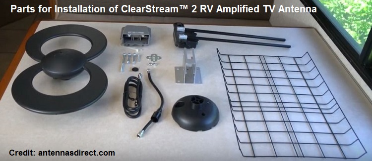

phone man 21-Oct-2019 11:44 PM
My C2V RV antenna is supposed to arrive tomorrow. The clearance issue with the VHF elements and my roof air conditioner was addressed by a support tech who said I could move the VHF mount over a couple inches and zip tie it to the reflector as needed.
I was curious about the weight difference between the Sensor III and the C2V RV. Surprisingly the C2V is lighter by a few ounces.
phone man 22-Oct-2019 9:23 PM
From our driveway in the same position, the Winegard Sensar III received one channel. A PBS affiliate 39 miles away. The C2V-RV is picking up four additional channels (ABC. NBC, CBS, FOX) and their sub channels 43 miles away. All are within 10 degrees of each other. This will be interesting to try at campgrounds where I'm familiar with TV reception.
Moving the VHF over a couple inches worked well and clears the roof AC as I'd hoped. Due to short coax on the boom, I had to mount the pre amp on the back side of the antenna screen. AD Tech, am I causing any problems by doing this? I can make a longer cable and mount in below the screen if it matters. I do not have any dicor self leveling sealant on hand so I didn't want to replace the factory coax at this time.
