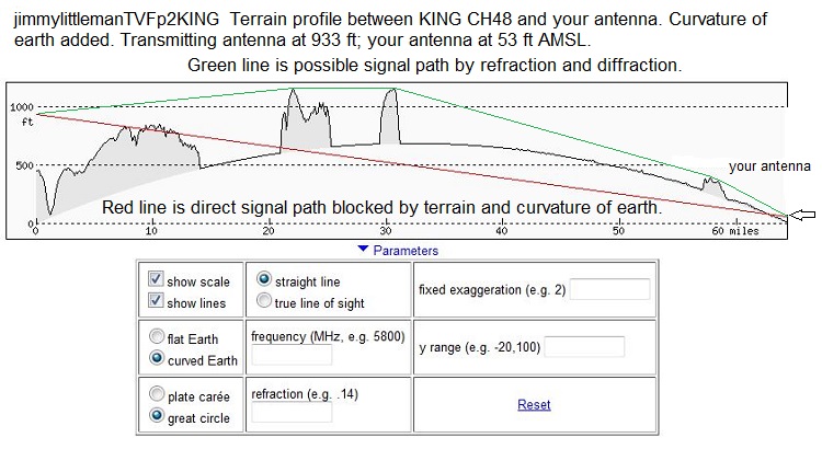

There are three possible causes of declining reception at your location:
1. Deterioration of your antenna system; you have had it up for many years.

3. Changes in the transmitted signals from Repack by the FCC, as previously mentioned.

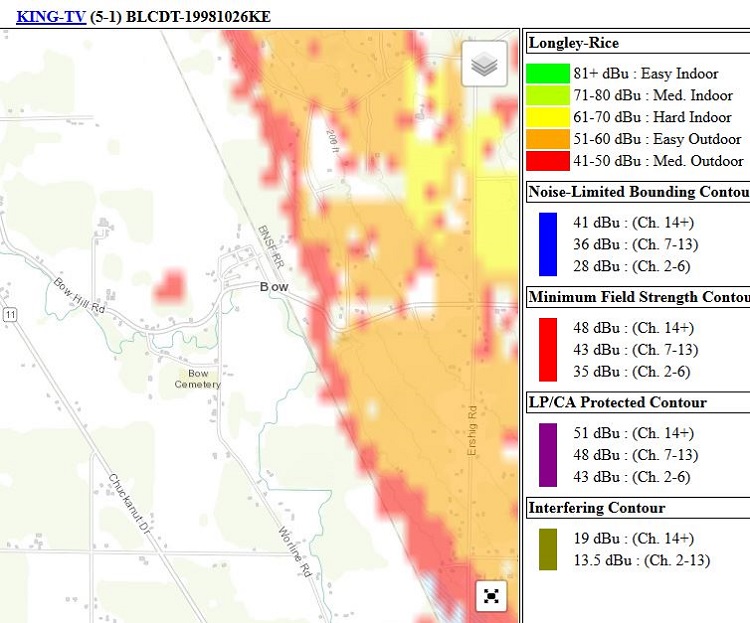

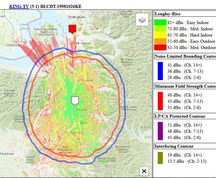

You are outside the KING area of coverage:
https://forum.tvfool.com/attachment....2&d=1569288640
The coverage at Bow is very spotty. Red is the weakest listed color; no color is weaker.
https://forum.tvfool.com/attachment....3&d=1569289069
