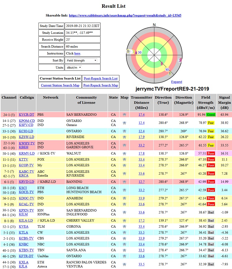

Current TVFool report:
http://www.tvfool.com/?option=com_wr...90385d21dbceed
Report from rabbitears.info, which should be more accurate:
https://www.rabbitears.info/searchma...study_id=13545
Extract from rabbitears.info report:
https://forum.tvfool.com/attachment....4&d=1569117197

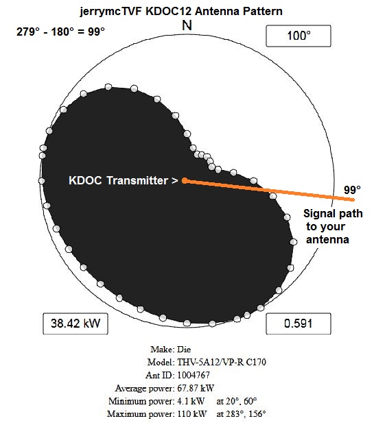

You are behind a mountain for KDOC, jerry:
https://forum.tvfool.com/attachment....5&d=1569117594
Your location is on the edge of the red zone of the Longley-Rice coverage map, which is the weakest listed signal strength.
https://forum.tvfool.com/attachment....6&d=1569161131
Because of the directional KDOC transmitting antenna pattern, less than 38 kW out of 110 kW ERP is sent in your direction:
https://forum.tvfool.com/attachment....7&d=1569164326
