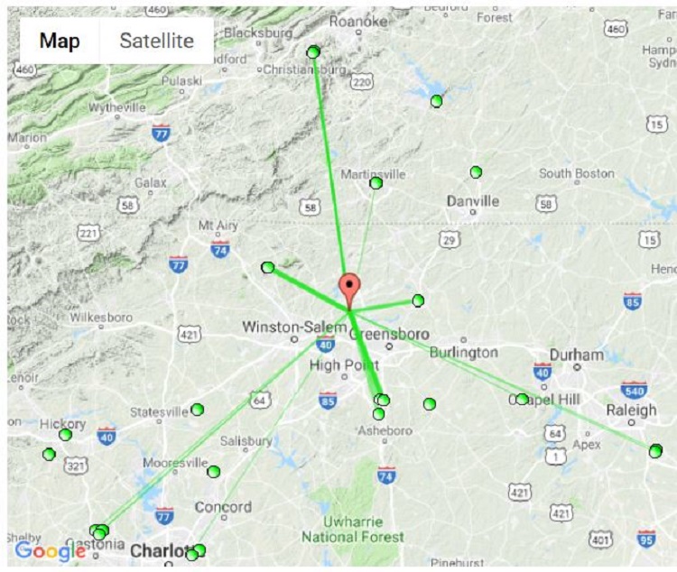

tuffones 15-Sep-2019 1:17 AM
lost channels from Roanoke VA
http://www.tvfool.com/?option=com_wr...903858d10d5335
I used to get those channels 3,18,17,30,36 Yellow from the North, outside Roanoke, VA (I 'm pointing from NC). The antenna yagi 91xg used to get'm from behind, the yagi was aiming to the south Greensboro.
Today I aim the 91xg and dont show. I got a little yagi to replace my Y5713. This antenna Mediasonic HW-27UV with 9 elements is doing a good job getting channels from outside Raleigh, NC 40miles and south Greensboro.
I using a channel master to boost the signal and I got a Winegard combiner. Antennas are 24ft outside, I live up on the hill.
How can I find out changes in those towers outside Roanoke, VA

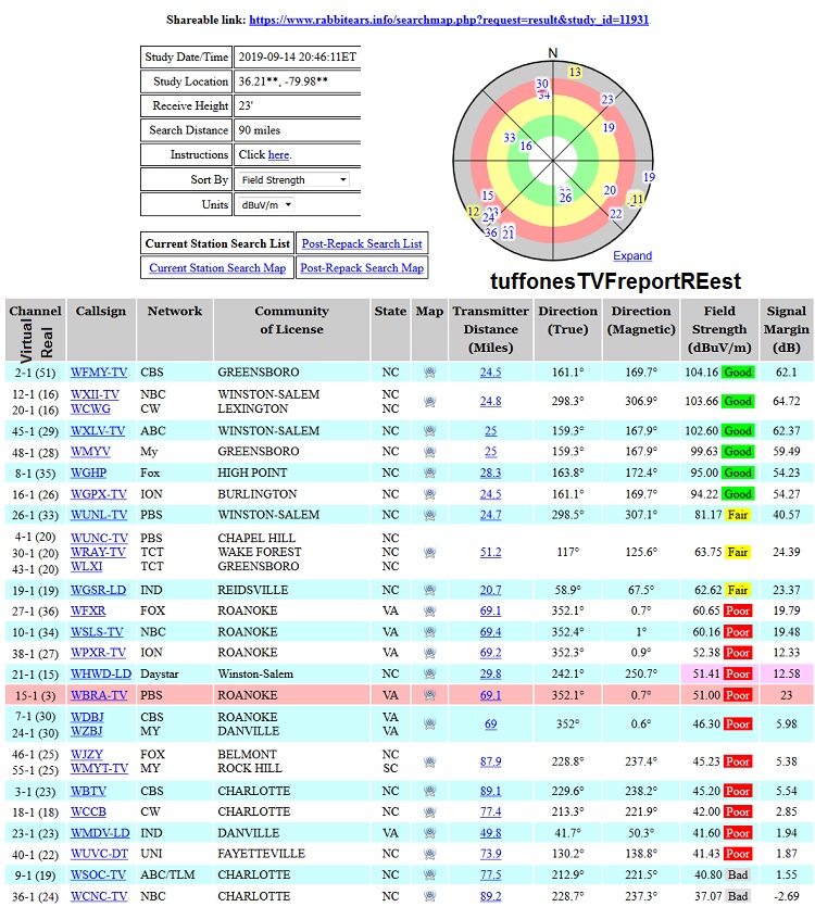

Thanks for the signal report. Here is a report from rabbitears.info based on my estimate of your location from your TVFool report. It should have a more accurate list of channels:
https://www.rabbitears.info/searchma...study_id=11931
This is the Repack plan for Roanoke:

I' m aiming the 91xg to Roanoke Va and the Mediasonic HW to the south towers. I m picking up all the channels from the south BUT the Charlotte and Raleigh only early in the morning. I can not get a solid signal afternoon, or evening.
Channel Master CM3410 PCT with Channel Master LTE Filter for 3G signals
Winegard Combiner CC7870
NOTE. months ago I used to have the 91xg south and the Y5713 aiming to Roanoke Va and picking those channels in the morning.

The link to your estimated rabbitears.info report again (I don't have your exact address):
an extract from that report:
https://forum.tvfool.com/attachment....4&d=1569785068
Using the Winegard CC-7870 Combiner is a lot like using a splitter in reverse as a combiner.
It doesn't always work because when the same signals from each antenna reach the combining point, they will interfere with each other if they are not in phase (arrive at the same instant).
https://forum.tvfool.com/attachment....5&d=1569787256
If you don't get all the signals when combined that you had when the two antennas were separate, that method of combining doesn't work at your location.
As a test, I suggest you aim just the 91XG at Roanoke without the combiner to see what you get.
Are there any trees or other objects in the signal path from the North?
