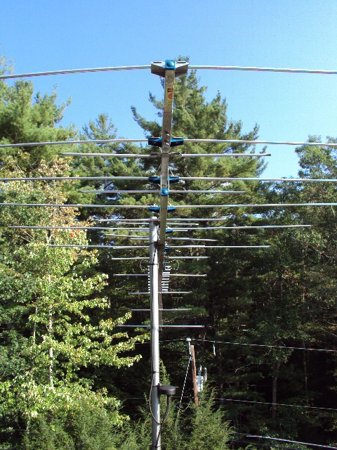

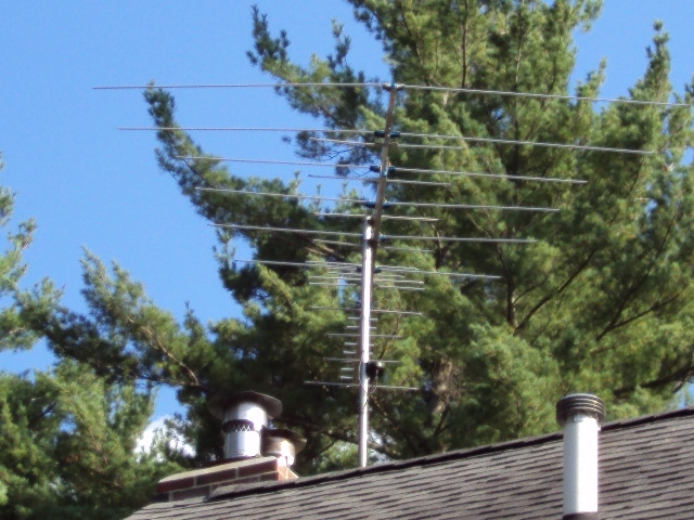

back in 2016 I tried unsuccessfully to cut the cord.. My only hold back is that I watch fox 25 (boston) news and was not able to get even a whisper of a signal.
I have an RCA ant3036X antenna. Aimed 161 deg mag.
I am now looking to use #1 a Kosmic Super Quad tuned to ch 31? #2 a Super Stealth Hawk? or #3 a Gray- Hoverman7?
Using the current ant I get more than enough other channels to view, my main concern is real ch 31 fox 25.1. Ch 9&11 come in perfect off the side.
Of the three options what would provide the best overall tunability to adjust for max gain at that freq? If this can be tuned to the peak of the waveform either side should still provide adequate gain to pull in the other channels as well.

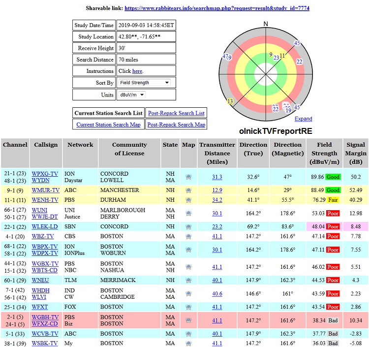

rabbit73 4-Sep-2019 12:11 AM
7 Attachment(s)
https://forum.tvfool.com/attachment....3&d=1567554407
https://www.rabbitears.info/searchma...&study_id=7774

Yeah, Repack is a mess and the cellular companies got the spectrum they wanted.

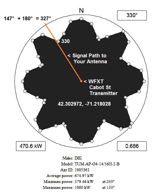

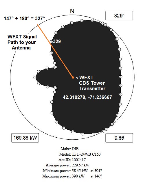

Right now WFXT 34 is probably using their CBS Tower transmitter:
https://forum.tvfool.com/attachment....7&d=1567552154

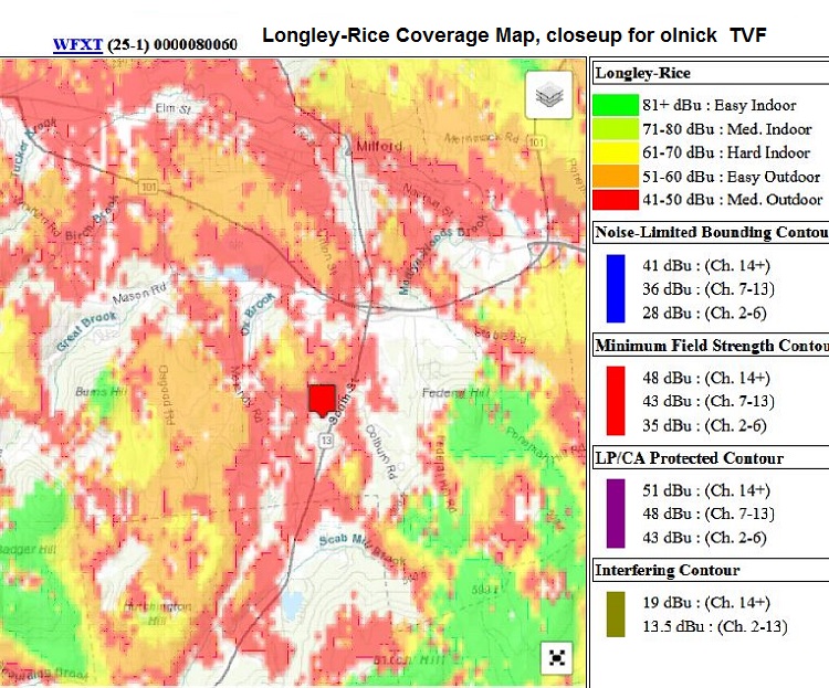

When they switch to their regular Cabot St transmitter, your chances should improve:
https://forum.tvfool.com/attachment....8&d=1567552202

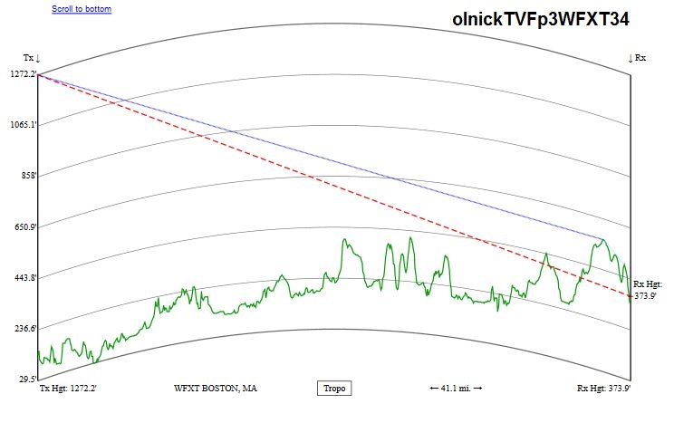

But, you will still have your old problems like the WFXT coverage is spotty in your area. Red is the weakest listed signal strength; no color is weaker:
https://forum.tvfool.com/attachment....9&d=1567552596

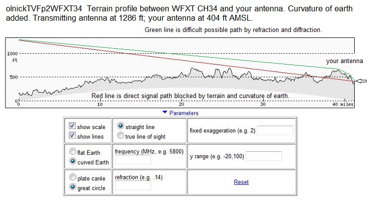

and there is a hill in the signal path just before your location:
https://forum.tvfool.com/attachment....0&d=1567552928
https://forum.tvfool.com/attachment....1&d=1567552951
https://forum.tvfool.com/attachment....2&d=1567552996
And the TREES surrounding your house that block TV signals.

Trying different heights is an excellent idea because of layering, but my main concern is with the trees that surround his house.
http://forum.tvfool.com/showpost.php...7&postcount=22
https://forum.tvfool.com/attachment....5&d=1567628348
https://forum.tvfool.com/attachment....6&d=1567628796
https://forum.tvfool.com/attachment....7&d=1567628825

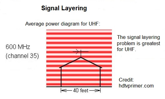

Tower Guy mentioned lowering the antenna to find the "sweet spot" what is the distance between the layers? Am I looking at 6 inches or 3 feet to find the "sweet" spot? It might be easier to go up 6-8 inches with a re location of my chimney mounts rather than going down 20-25 inches!
Thanks
Olnick
OTAFAN 11-Mar-2020 11:33 PM
According to hdtvprimer.com and posted in another thread by rabbit73 similar to #13 above:
"For UHF the strong and weak spots are often 5 to 20 feet apart. If you are in a neighborhood with overlapping fields, moving your antenna a few feet can make a huge difference in signal strength. The chimney might seem like the perfect site, but if the chimney is in a weak spot then the chimney is a mistake. To make matters worse, the pattern of strong and weak spots will be different for different frequencies."
http://www.hdtvprimer.com/ANTENNAS/siting.html
If I can find rabbit73's post of Signal Layering/Overlapping Fields I'll edit with link or perhaps he will chime in with it.
