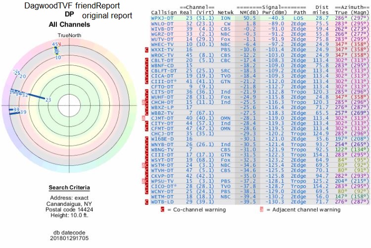

I'm trying to help a friend find what is available where he lives. These maps and links are beyond confusing.

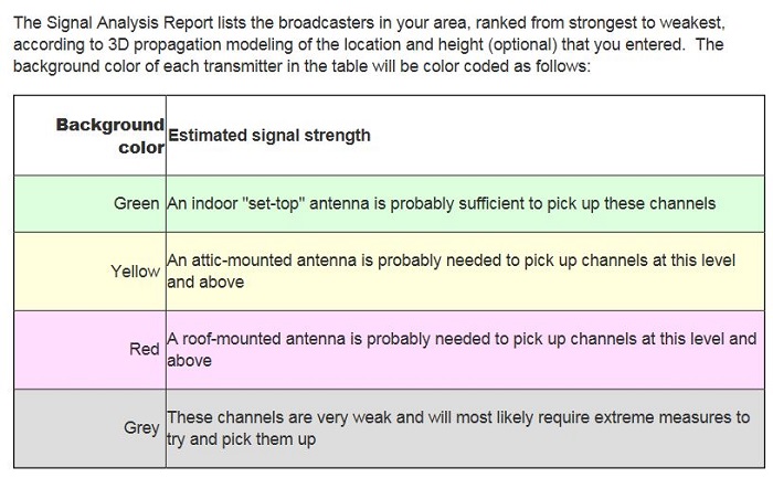

Here is the analysis, but I don't really know what I'm looking at. The coded colors are very faint and hard to decipher:

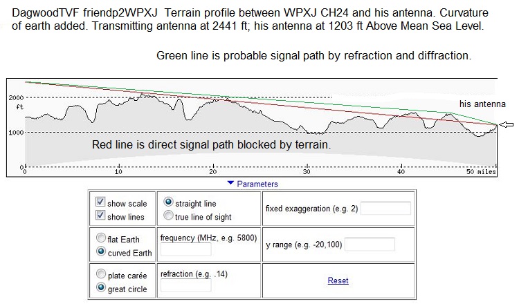

Also, there is a way of making a side (profile) view of the terrain, etc. showing the signals as they go through the air. Somebody (Rabbit?) did this for me a few years ago and I'd like to get this for my buddy. But the myriad of links and unfamiliar terms has me lost.

rabbit73 14-Aug-2019 8:18 PM
Hello, Dagwood
Thank you for the report for your friend.
There is only one strong signal in the green, none in yellow, 4 in the red, and the rest in grey are very weak. Doesn't look very promising.
http://forum.tvfool.com/attachment.p...1&d=1501512769

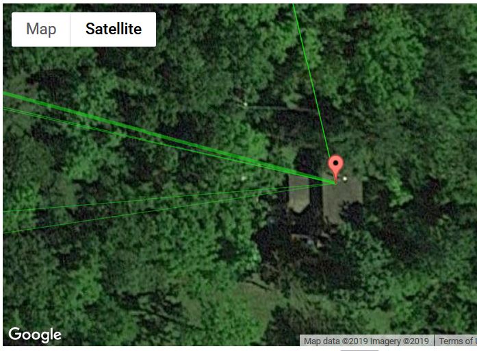

Yes he has trees, but mostly is down in a valley similar to me -- only worse.
Thank you for the additional information.
I looked at the satellite view. You are right; it does look worse than your location. He is surrounded by trees that will block TV signals:
https://forum.tvfool.com/attachment....4&d=1565877710
and he is down a hill:
https://forum.tvfool.com/attachment....5&d=1565879135
Even with a big antenna as high as he can get it, he will not be able to get much.
rabbit73 15-Aug-2019 4:15 PM
3 Attachment(s)
This is an image of his signal report:
https://forum.tvfool.com/attachment....6&d=1565882026
The above report is based on his address, which is from a marker further down the hill.
This report is based on the coordinates of his house which is at the north end of his lot (I think), further up the hill; the signals are stronger:
https://forum.tvfool.com/attachment....7&d=1565882095
This is the link for the revised TVFool report based on the coordinates of his house:
http://www.tvfool.com/?option=com_wr...90386a1d9f6f12

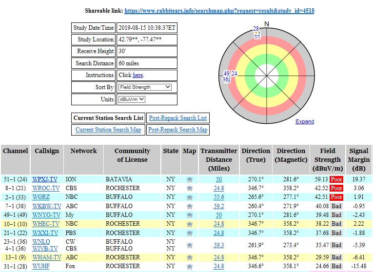

This report is from rabbitears.info:
https://forum.tvfool.com/attachment....8&d=1565882420
This is the link for the rabbitears.info report:
https://www.rabbitears.info/searchma...&study_id=4518
He might have a chance of getting a few of the ones at the top if he uses a Solid Signal HDB91X or an Antennas Direct 91XG antenna and a preamp like the Antennas Direct Juice or the older Antennas Direct PA18.
rabbit73 15-Aug-2019 6:47 PM
2 Attachment(s)

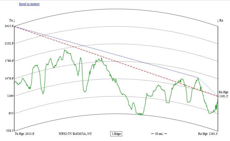

There are several ways of looking at a terrain profile beween a transmitter and his location.
If you click on the rabbitears.info report for his location
and then click on the Transmitter Distance (Miles) for a channel, a profile for that channel will come up. This is what the WPXJ terrain profile looks like. The red line is the direct signal path blocked by terrain; the blue line is the probable signal path.
https://forum.tvfool.com/attachment....9&d=1565891253
There is a profile available from TVFool, but it is no longer correct because the WPXJ transmitter moved when it changed real channels from 23 to 24:
http://www.tvfool.com/?option=com_wr...dALLTV%26n%3d1
This is the WPXJ profile using other software:
https://forum.tvfool.com/attachment....0&d=1565893676

So Rabbit, boiling this all down, what would he get with the biggest roof antenna with a booster and rotor?
We don't really know what he would get because the signal reports assume that the antenna is in the clear and there are no TREES or buildings in the signal path. He will just have to try it.
My guess is that he has a good chance of getting a few of the strongest ones at the top, but it isn't possible for me to give a guarantee.

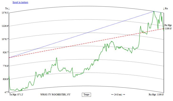

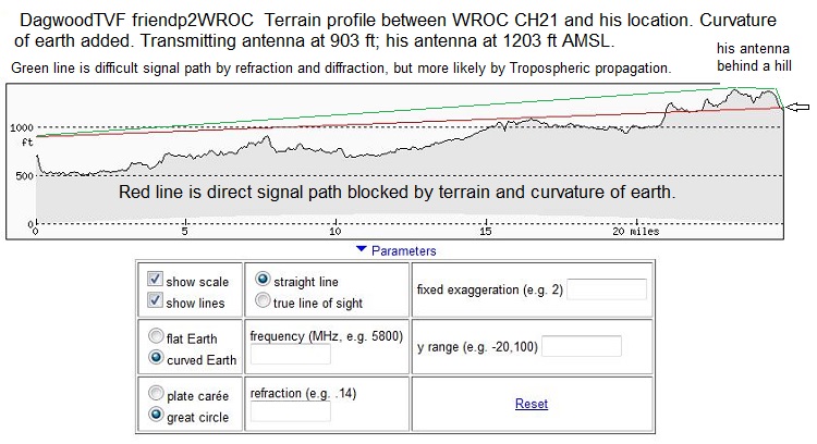

WROC has moved to channel 21, but the transmitter is still at the same location. This is the profile by TVFool for his location:
http://www.tvfool.com/?option=com_wr...dALLTV%26n%3d8
This is the WROC profile from the rabbitears.info report for his location by clicking on distance in the report:
https://forum.tvfool.com/attachment....1&d=1565895259
https://forum.tvfool.com/attachment....2&d=1565897142
Again, the terrain blocks the signal even before it gets to the TREES.
