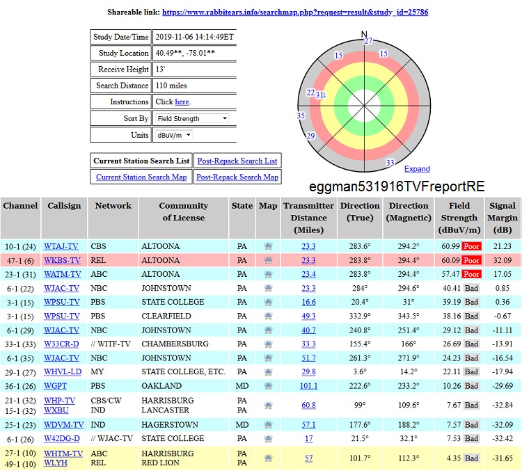

What does your TVFool signal report look like?

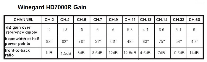

This is what the Winegard HD7000R looks like with the VHF-Low extensions added:
https://forum.tvfool.com/attachment....5&d=1572964727

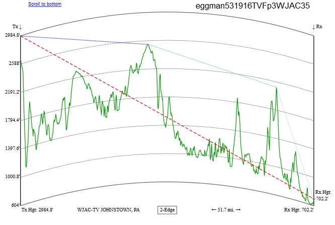

eggman531916 6-Nov-2019 5:11 PM
http://www.tvfool.com/?option=com_wr...90386ebd6201d7
My TVFool report. It's not very accurate as these are the old listings and the channel I'm trying to get isn't even on there BEFORE the switch. Actually, my NBC station used to come in on RF 34 which isn't on the report either. They switched to RF 35 around the same time and signal now cuts in and out. Maybe an LTE filter is needed? I don't know. I haven't had a chance to try anything yet. Hopefully over the weekend. I apologize as I just now have only had a chance to check the thread and am getting ready to run out the door to work. I'll look over everything everyone has posted ASAP. Thank you all.
