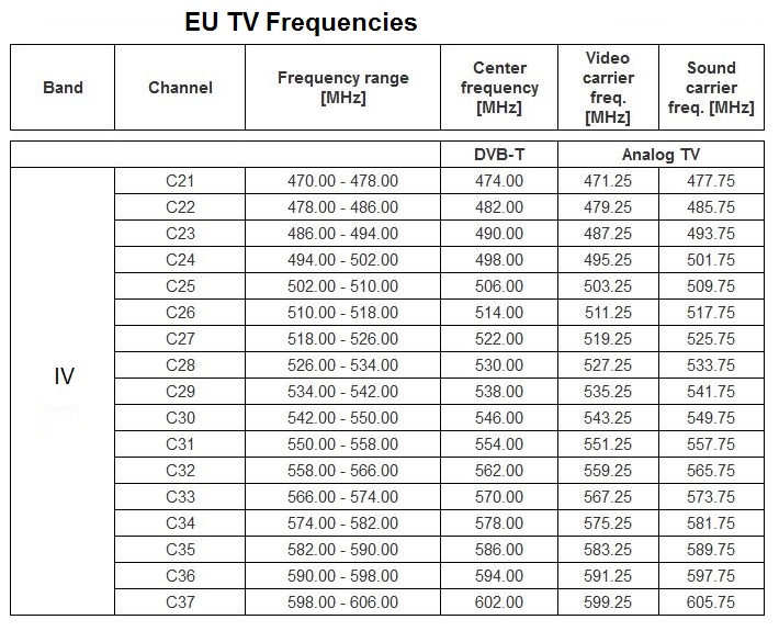

I haven't figured it out yet but he said the channel 20 through 37 antenna actually is good for the US Spectrum of 14 through 37. Maybe their bands are wider, wider than 6 megahertz like hours?
Yes, their channels are 8 MHz wide instead of 6 MHz like our channels.
https://forum.tvfool.com/attachment....1&d=1558635321
Source:
https://www.dipolnet.com/tv_channels...-dk__bib02.htm
Their Band III (similar to our VHF-High) has channels 7 MHz wide.
http://igorfuna.com/dvb-t/digital/tv...el-frequencies
