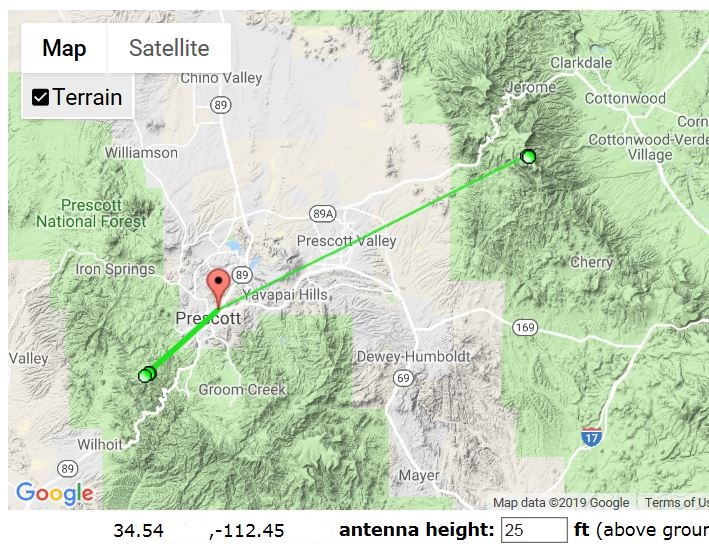

rabbit73 30-Apr-2019 9:05 PM
1 Attachment(s)
Originally Posted by JoeAZ (Post 61456)
Finally, I kept the 4 Bay UHF antenna pointed at Mingus and put a UHF 2 Bay directly behind the 4 Bay, pointed at Mt. Francis.
Voila!!!!!!!!! I got everything from Mt. Francis and everything
from Mingus Mtn PLUS NBC on Rf 22 and Rf 13 as well.
I then connected the 2 bay antenna to see how it performed with the 4 Bay at it's back. Received all Mt Francis, all Mingus Mtn, plus NBC on Rf 22. It is weak but consistent.
Interesting setup. I read it a few times, but also don't quite get it yet. A diagram and photos would help.
This map and TVFool report are based on your description:
https://forum.tvfool.com/attachment....6&d=1556654570
http://www.tvfool.com/?option=com_wr...90388502dba84a
Please post your TVFool report. I'm not certain how close my guess is.

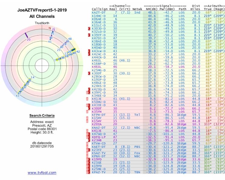

rabbit73 1-May-2019 8:38 PM
2 Attachment(s)
Thank you for more details. It seems to work well for your location.
http://www.tvfool.com/?option=com_wr...9038cc35391921
https://forum.tvfool.com/attachment....7&d=1556739474
https://forum.tvfool.com/attachment....9&d=1556740807
https://www.rabbitears.info/market.p...&callsign=KDFQ
https://www.rabbitears.info/market.p...&callsign=KNAZ
I don't think it's exactly what Bob was looking for. He wants to combine the coax lines from antennas aimed in two directions into one coax line without the loss of any channels. He will need to hunt a little longer, or resort to more conventional proven solutions.

Just an aside. Both the TV Fool and the rabbitears have significant errors
and/or omissions. Of the two, rabbitears is more accurate. I have NEVER
seem KDFQ in any of my travels. I also believe that the KNAZ and KFPH
signals are much better than either report indicate.

KDFQ was analog on 47. It is now licensed for digital on 27, but is silent.
https://www.rabbitears.info/tvq.php?...ems&facid=7369
http://www.fccinfo.com/CMDProEngine....6308c9d99a17aa
Tower Guy 3-May-2019 12:06 AM
Yes, the database on rabbitears.info is just about perfect. The current tvfool database has the locations of many of the repacked stations as longitude 00 00 00 and latitude 00 00 00. This seems to be true especially for stations that maximized their power during the repack.
The other differences between the results would be due to the precision of the terrain databases used by each calculation. Even the FCC allows various block sizes when stations calculate inter-station interference.
JoeAZ 3-May-2019 12:10 AM
Previously, Rf 47 was the ABC 15, KNXV translator here in Prescott.
It was always on Mt. Francis as I recall. If I recollect correctly, there
was another Rf 47 but that station was not receivable in Prescott nor
Prescott Valley. The transmitter was well South of Prescott and it
was directional towards Phoenix. Perhaps that is the "phantom"
KDFQ. Perhaps one of you could elaborate as to why something
similar to my system wouldn't work for Bob????
