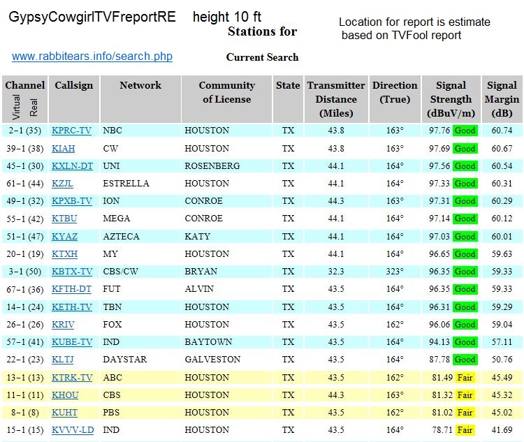

rabbit73 9-Apr-2019 11:06 PM
1 Attachment(s)
Here is a report from rabbitears.info which should have a more accurate list of channels:
https://forum.tvfool.com/attachment....5&d=1554847586
I suggest the Winegard HD7694P antenna which has extra VHF-High gain for 13, 11, and 8 that are weaker. A dipole might not be sufficient for those channels; testing would be required. The antenna should be located with the fewest trees in front of it; trees block TV signals. Please look at the link that ADTech posted above:
It's OK to use the Dish coax if it is in good condition, but you should remove any of the other Dish equipment and devices; they might not be suitable for OTA reception.

Other than the trees being fully covered with leaves now, nothing changed. But, ABC and CBS were pretty much gone. If one worked in one room, it did not work in the other room. The more the trees came in, the worse the reception was, with channels dropping all together, or having a lot of pixelation.
When the antenna was moved more toward the SE, ABC came in clear in the living room, and all pixelation stopped on ABC.
However a lot of channels were lost all together. In the living room the TV brings in NBC, ABC, TBN, PBS, KTHX, KLJT, FOX, Kube, Escape, ION, Advent, KFTH.
In the other room, there are four main channels, and their group channels. The main channels are NBC, KTHX, FOX, and ION, but ION is lightly pixelated.
bobsgarage 18-Apr-2019 1:05 PM
Welcome back
Welcome back and thank you for posting results. I am the one who made the comments about those who come looking for help and never post the results. I apologize I was a little too soon on that. Everybody here figured after a week or two you weren't coming back.
Although the C2 Max is a very capable antenna, the C4 Max might have been a better choice or even something larger I hate to say. Adding a reflector to the C2Max would help it. It will make it more directional. You will then be committed only to the signals from the southeast.
As the foliage expands on your tree we will block your signal more, I'm sure of that. some of the larger 4 Bay and 8 bay antennas supposedly work better through the trees. We'll see what the consensus is.
The others will come here I hope, to help you with your reception issue. what is the reasons for me to post is possibly to get you to take a picture of your setup and post it here. you can easily upload photos for getting them to show in the post is another story but at least we can follow the link to your picture.
iI the meantime, maybe you can access your signal meter on your TV? maybe take your DVR out of the loop for the time being until you get good reception?
ADTech 18-Apr-2019 1:46 PM
Welcome back, good to see you're still working on this issue.
In your most recent post, you indicated that the antenna is installed "attached to the post where the LNB was located at the DirecTV Dish". That is a concern as it is not clear if the antenna is installed so that it is correctly oriented. If it was simply affixed to the LNB mounting arm with the included mast clamps, it would be impossible for the antenna to situated so it is vertical (with respect to the ground), it's correct orientation. However, if the dish were completely removed and the antenna attached to the now empty vertical mast section of the mount, then it is properly oriented.
All of your Houston major stations come from what is, from your location, exactly the same place. There should never be any need to do anything other than face the antenna towards the tower farm (164° true). If you are rotating the aim of the antenna some and getting different stations out of the main Houston assortment with different results, then that leads me to the conclusion that at least one one of three following things are amiss: 1) The antenna is incorrectly installed (see above), 2) The dish is causing undesired reflections back to the antenna, or 3) The direct signal path is blocked by physical objects and you're getting reception of signals that are diffracting around the signal path impairment.
If you are intending to use the dish mounting location, then it is imperative that you either get rid of the dish or that you extend the mast several feet above the dish so that it does not have the opportunity to wreak havoc on your TV signals. If Directv used one of those "stubby" roof mounts, you'll need to extend it.
If that location does not offer the best available line of sight towards Missouri City, then it is highly recommended that you relocate the antenna to a more appropriate location if one is available. The expected improvement in reception will likely make the extra effort very worthwhile.
As I cannot see your exact location or your installation, I can only draw inferences from what you've provided. The invitation extended previously to contact me directly is still open and is still recommended.
Your cable runs are very modest, no amplifier should be needed if you can get the antenna installed appropriately. Adding an amplifier at this point in the game is more likely than not the equivalent of putting a Band Aid on a serious injury.
