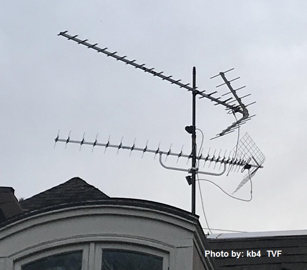

Exactly need Rabbit73 . Have actually three different antennas I had two directional both pointed at WYJJ and one non directional and tried one with and without amplification just for heck of it. I will look at rabbit ears site etc.

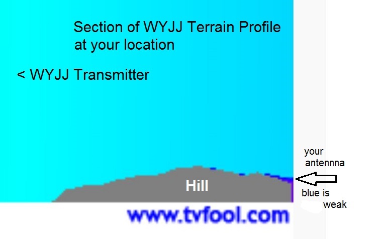

Thank you for the PM. I do see the trees in a satellite view. Trees block TV signals:

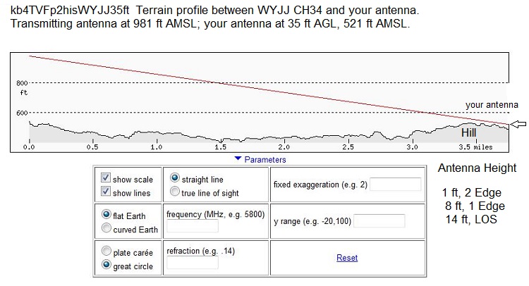

Besides the trees, you are in the shadow of the hill:
https://forum.tvfool.com/attachment....2&d=1554775148
The signal would only be LOS if it cleared the hill and the trees on it.

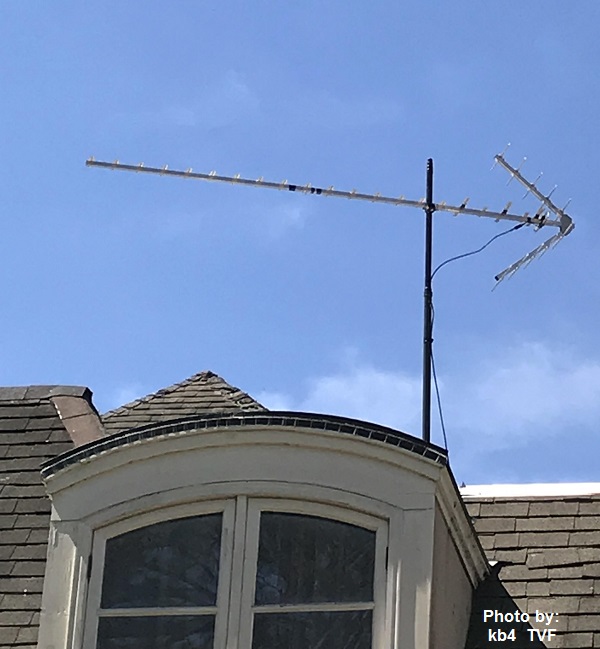

ok I got up on roof today and put up a temporary mount stand (no wind at all today) and found a winnegard uhf only antenna I think a 9032 in my storage container that i bought years ago to put up at a hunting trailer and never did.
I installed this at about 30 feet for now and if link successful this is a pic of the view toward WYJJ
/var/folders/rb/t24db8410r39tw7pfgnkbrqh0000gp/T/com.apple.iChat/Messages/Transfers/IMG_5253.jpeg
Yes, there are a lot of trees and beginning to leaf out pretty strong but as you hopefully can see there is also blue sky visible and this is taken for about 25 feet. It seems as though the antenna and certainly another 10 foot higher or so would be able to clear the hill or close but maybe not.

1. rabitt73 did the pic indicating the hill blocking my antenna location show my antenna height of 35 feet I indicated. If so I must be looking up at an angle that would end up more than 400 ft high or so 3.7 miles away. More out of curiosity than anything can you tell fairly easily how high the antenna would have to be to get out of the weak zone.

Very brave. Thanks for the photos; they always help to understand the problem.
The trees will always be a problem until you can get above them.

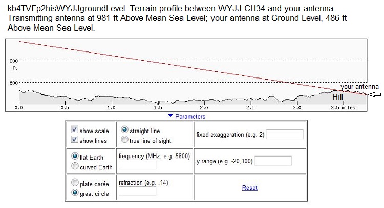

That image in post #8 is from a WYJJ terrain profile done by TVFool. I added the arrow to indicate the approximate height of your antenna:
http://www.tvfool.com/?option=com_wr...dALLTV%26n%3d6
No, not easily because the vertical scale is exaggerated. When I have more time, I will do a profile with other software that might help.

thanks for the answers to all the questions. I added some eyelets and temporary rope tie downs as the wind picked up some and is supposed to be about 18 mph by noon tomorrow. Since dark the reception improved some with few dropouts but still quite a few pixelations but the signal strength remains at about 45 max.
Its hard to tell in the picture but the antenna is tilted up toward WYJJ some.

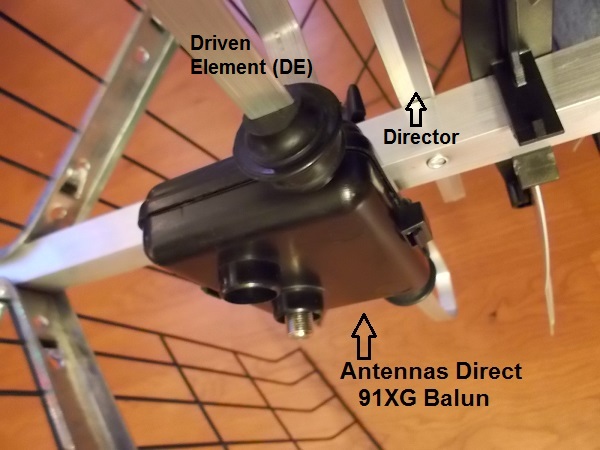

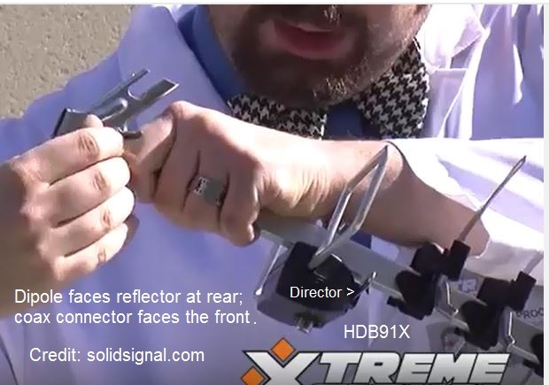

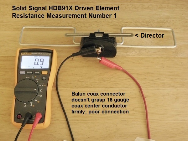

an un related question. I received the xg91 today that I was going to try this weekend and when assembling it I noticed that one boom joint comes together touching each other the one closest to the reflectors and the other two sections have about a 16 th of an inch gap between the booms and though the braces are same length it looks like space to the hole not the slot is a little less on one of the brackets . I could easily modify the hole or the slot to make the boom sections touch each other like I would think they should. I am unclear as to whether this is intended or not. I can call antennas direct tomorrow and see what they say if no one knows. Also there is an element just in front of the dipole that is permanently mounted to the boom that I have not seen in any pics of the antenna. Just wondering if this is supposed to be there or maybe it was a return and not correct parts. I will try to post pics
https://imgur.com/dSDnzV6
https://imgur.com/eDEBg1N
https://imgur.com/X9n4GxU
Again any help would be appreciated
