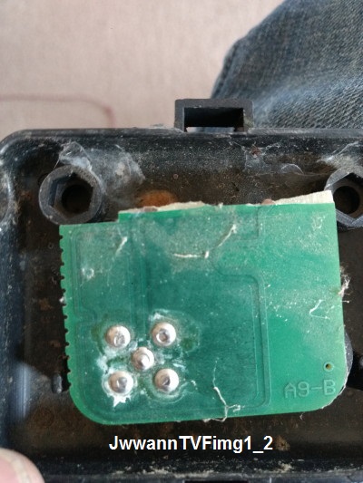

Jwwann 26-Mar-2019 11:28 PM
Whats is this called? It broke on my uhf antenna
https://pasteboard.co/I7gJS4v.jpg
Jwwann 26-Mar-2019 11:32 PM
https://pasteboard.co/I7gI4aW.jpg
rabbit73 26-Mar-2019 11:42 PM
2 Attachment(s)
Hello, Jwwann
https://forum.tvfool.com/attachment....7&d=1553645167
https://forum.tvfool.com/attachment....8&d=1553645187
It looks like a PCB (Printed Circuit Board) balun, which matches the antenna to the RG6 coax downlead.
What make and model is the antenna?
rabbit73 27-Mar-2019 12:13 AM
1 Attachment(s)
If that is from an Antennas Direct 91XG, they have a lifetime replacement policy for that part.
https://forum.tvfool.com/attachment....6&d=1553644422
ADTech 27-Mar-2019 2:19 AM
Yep. Just fill out the form linked to in my signature (below) and we'll get it take care of. Specify "91XG balun assembly".
Jwwann 27-Mar-2019 4:33 AM
That's it! Thank you very much everybody.
