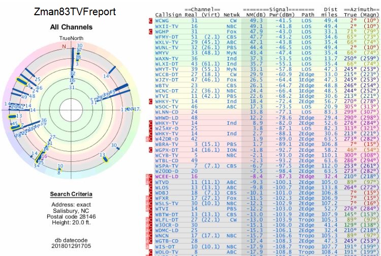

rabbit73 8-Mar-2019 6:57 PM
1 Attachment(s)
Hello, Zman83; welcome to the forum.
Your might try a bi-directional antenna like the Antennas Direct Clear Stream 2MAX without a reflector, which could be aimed to pick up NE and SW.
https://forum.tvfool.com/attachment....1&d=1552071340
Try the CS2MAX with just one TV first, then add a splitter. If the signals are too weak at the second TV, replace the splitter with a Channel Master 3412 distribution amp.
https://store.antennasdirect.com/Cle...V-Antenna.html
If that doesn't work, you will need two antennas.

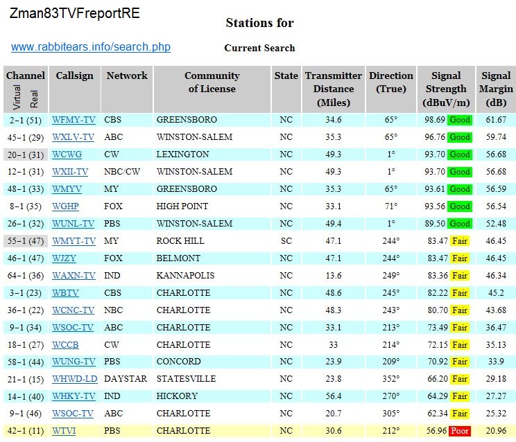

rabbit73 9-Mar-2019 6:21 PM
2 Attachment(s)
Originally Posted by scott784 (Post 60869)
I noticed one error in the TVFool database. It is not listing the main WSOC (ABC) Channel 9 broadcast channel on RF34 from N. Charlotte. The WSOC TV listed on his TVFool Report is for a WSOC translator located near Statesville, NC (RF46), which is off the air at this time.
This is the TVFool report:
https://forum.tvfool.com/attachment....1&d=1552155400
A report from rabbitears.info has a more accurate list of channels:
But I will also note the missing WSOC (ABC) station Channel 9 on RF 34 is located in the same area of N. Charlotte as is the tower for WCCB (CW) Channel 18 on RF27 that can be used as a point of reference until the database is correctly updated.
TVFool is not likely to make any corrections with such a small staff.

Zman83 10-Mar-2019 6:39 AM
Thanks everyone for the responses, it is definitely appreciated! In reference to the rabbitears.info report, with exception of the WUNL, I receive all of the "good" signal stations from the report on the small rabbit ear antenna that I first described. I would like to keep those and gain some of the other networks that are in the Charlotte/Gastonia area, since I do live between the two markets and may be able to get some of the "best of both worlds"; I think the possibility of receiving one of the markets off of the backside of an antenna is definitely worth a shot. I will look into the Clearstream 2Max or 4Max that was mentioned, as it will give me an idea what channels I can receive reliably (or at all), and if I do get it locally (again, as someone mentioned) then I should be able to return it without having to pay return shipping, depending on how well it works. I may try to pick up a signal meter somewhere too. So, thank you all for the comments and suggestions. I will try to post an update soon.
