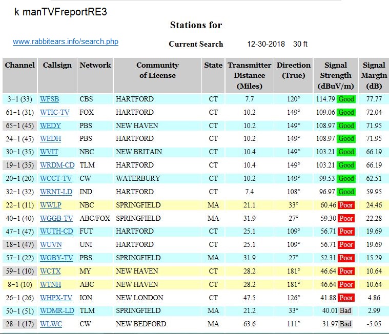

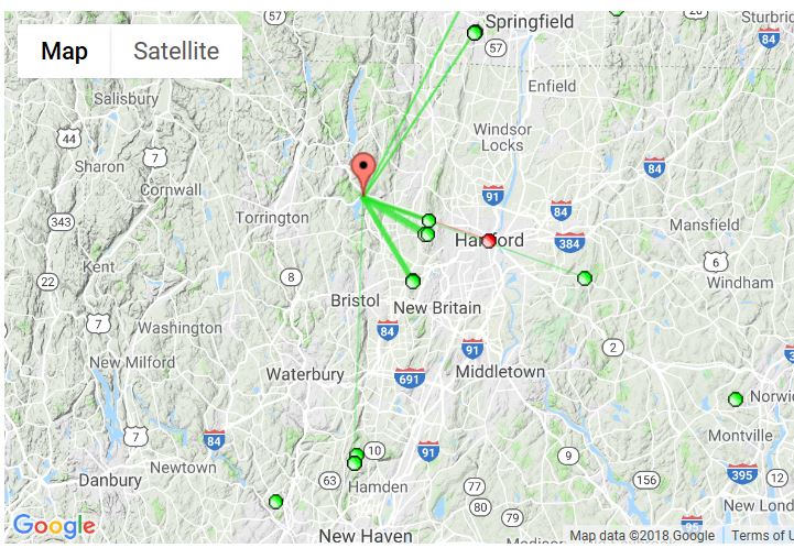

Signal report from rabbitears.info for comparison:
http://forum.tvfool.com/attachment.p...1&d=1546203936
This shows channel changes for Hartford by the FCC Repack:
https://www.rabbitears.info/market.p...&callsign=wtnh
for Springfield:
https://www.rabbitears.info/market.p...&callsign=WGGB
Most of the channels you want are from Hartford and are strong. You can get them with a UHF antenna like an Antennas Direct DB4e or C2V and no preamp. The C2V is being replaced with the C2MAX. Add the accessory reflector if you get the C2MAX.
The problem comes with ABC. You will need a separate antenna for ABC and a preamp.
You have the weak WGGB in Springfield, now on UHF real channel 40, but moving to channel 26 during Repack Phase 8, 1/18/2020 to 3/13/2020.
You also have the weaker WTNH from New Haven on VHF real channel 10. It will require a separate high gain VHF antenna like the Stellar Labs 30-2475 or 30-2476 and a preamp.
You will have to do some experiments to see which ABC you can get, and then figure out a way to combine it with your Hartford UHF antenna.

k man 31-Dec-2018 2:37 AM
Thanks for the quick reply
Yes, it is the same report- since i posted last, i have installed roof mounted antennas that do a pretty good job for me. In non technical terms, i have a vhf antenna pointed northeast 50 degrees, combined with a uhf antenna pointed southeast 130 degrees.
I am only posting now to see if they’re is a better solution for my uhf channels ( my vhf pointed northeast works great)
The problem i have with my uhf is some stations get spotty, jittery reception with wind, and my guess is because the uhf antenna i have is too directional
I get great reception all the time from:
Wvit, wfsb, and wcct.
I get spotty reception (especially from wind) from”
Wtic, and wedh
So, looking at my report, would you say a non directional uhf antenna to be better than a directional?
If so, i am looking to replace the uhf antenna i have now.

Thank you for the additional information, Dave. I thought it was overload, but you are getting weaker channels. I thought it was direction, but you are getting good and bad from the same direction. That just leaves antenna aim and trees.
Can you show us a photo of the antennas and a view of looking SE at 149 degrees?
If you tell me your address and the coordinates of your antenna in a PM for privacy, I can look at a satellite view of the signals lines and see if there are any obstructions. If not, I can't figure it out and blame the trees. Does reception improve when the leaves fall?
