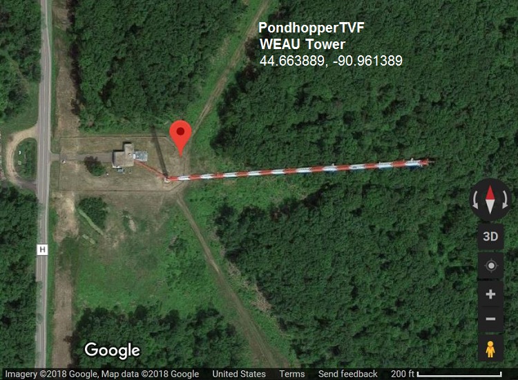

PM from Pondhopper:
Originally Posted by Pondhopper
Rabbit,
Can you post that WEAU out of Eau Claire Wisconsin is at 0N0E rather than it's true location of N44.663712°/W-90.961661°. I have registered twice, and have not recieved the "authorizing email" that would allow me to post.
Thanks.
I see that WEAU isn't listed on a report for Eau Claire. There are many errors in the database used to generate reports because of Repack changes. I doubt that the database will be corrected because of a shortage of TVFool staff.
http://www.tvfool.com/?option=com_wr...90387dca57fd60
but it is listed at rabbitears.info:
https://www.rabbitears.info/market.p...&callsign=weau
Which lists it at
Location: Pea Creek (WI)
44° 39' 50" N (44.663889) Latitude
90° 57' 41" W (-90.961389) Longitude (NAD83)
http://forum.tvfool.com/attachment.p...2&d=1533510578

rabbit73 22-Aug-2018 2:31 AM
1 Attachment(s)
PM from Pondhopper that gives link for 0,0 coordinates for WEAU:
Thank you for the link. It does indeed show 0,0 coordinates for WEAU. My guess is that if it has been dropped from the database in error, it will not be included in a TVFool report and there will not be a coverage map available.
Here is the FCC Longley-Rice coverage map for WEAU:
http://forum.tvfool.com/attachment.p...7&d=1534902615
and this is the link to the map:
https://www.rabbitears.info/contour....a&site=1&map=Y
