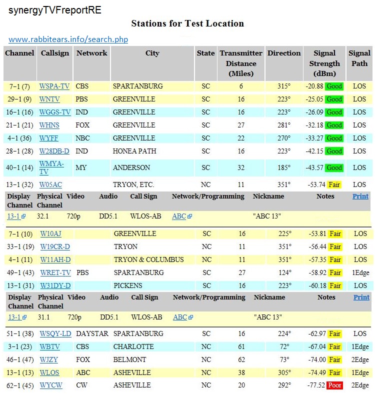

I received wonderful advice several years ago on which antenna to purchase and so I'm here again asking for an elderly friend that wants to switch to OTA. Could someone help me with what type of antenna to buy for my location and it will be placed in my attic. Below is my signal analysis~

The report that you did used the old database datecode 201711011344, that has a few errors. TVFool just started using a new more accurate datecode 201801291705 that shows the missing WSPA CBS on real channel 7:
http://www.tvfool.com/?option=com_wr...90384fbd079eb6
http://forum.tvfool.com/attachment.p...5&d=1517361288
Unfortunately, your channels are in different directions, and some are much weaker than others. Which channels are most important to you?
ABC is on W05AC and W31DY translators.
http://forum.tvfool.com/attachment.p...4&d=1517360483

I suggest a Stellar Labs 30-2475 VHF-High antenna aimed at 322 degrees magnetic for WSPA CBS on real channel 7.
http://www.newark.com/stellar-labs/3...vhf/dp/48Y8141
and an Antennas Direct DB4e aimed at 280 degrees magnetic for WHNS Fox on real channel 17 and WYFF NBC on real channel 36.
https://www.walmart.com/ip/Antennas-...tenna/22087581
combine the two antennas with a UVSJ UHF-VHF-Separator-Joiner, AKA UHF/VHF combiner or diplexer.
https://www.radioshack.com/products/...itter-combiner
or
https://www.antennasdirect.com/store...Combiners.html
If you can't receive WLOS for ABC on the WSPA antenna, you will need a third antenna for W05AC or W31DY and an A/B switch.
