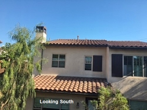

Thanks for the prompt replies. I added a few photos. We're on a hilltop, with a mostly unobstructed view.
In the LookingSouth photo, 173 deg is pretty much dead center between the two windows. Their rooftop is at most 10ft higher than mine.
The antenna could also go in the corner up on the hill, but not sure due to WAF.
Do I need to be above the neighbors house? And what angle would be best to align the antenna to?

You have a problem. Your antenna will not be in the clear. The neighbor's house will block the direct signals.
The antenna needs to be located where the signals are strongest, not where your wife wants it.
Yes, for best results.
Your signal report says 132 to 161 degrees magnetic. If your antenna was in the clear, I would favor more to 132, but since it isn't, the signals will come around the other houses in a way that is difficult to predict. I suggest you mount it in a temporary way without drilling holes to see what you can get.
The alternate location viewpoint looks a little more promising.

Thanks. Looks like I'll be doing some testing. The LookingSouth photo was taken from inside, not the roof. Judging by the offset of our second story windows, I'd estimate the difference to be ~5ft, so it's possible I might get a direct signal on my roof with a six foot pole.
Time to order the antenna, some cable and cross my fingers. I really appreciate the help.
