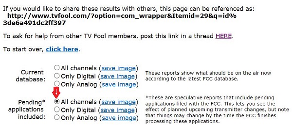

rabbit73 24-May-2017 2:37 PM
1 Attachment(s)
Welcome to the forum WilliamAtwood, and thank you for the update.
I'm not a member of the staff, but there is a shortage of people to keep the database current.
I think the problem is going to get worse with the many channel assignments being changed as a result of the shrinking UHF TV band.
Your tvfool report should look something like this:
http://www.tvfool.com/?option=com_wr...e6a47dda1b1003
If you click on Pending All channels in your report, CBFT and CBMT will be listed at the top, but the virtual channel numbers will be wrong.
http://forum.tvfool.com/attachment.p...1&d=1495634920
