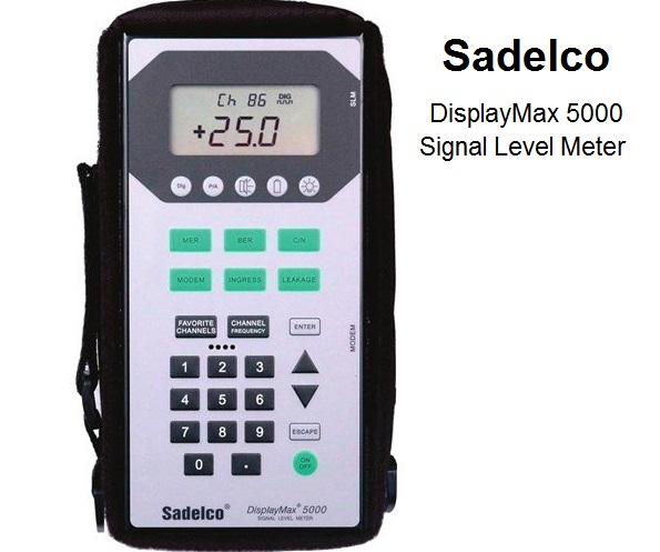

She also gave a DisplayMax 5000 to me:
http://forum.tvfool.com/attachment.p...1&d=1492308671
