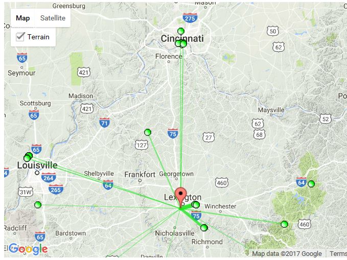

Looking at the attached signal report, I am thinking our choices are mostly UHF.
We have a two story home that faces due north. We have a chimney on the west end of the house that faces Louisville. I’m thinking to mount the antenna on the chimney on this west end of the house. This gives us building and tree free sky to the south, west and north and around 30' ~ 35' antenna elevation.
Here is our signal report...

WIRELESS ENGINEER 14-Jan-2017 7:13 PM
With the exception of wljc(rf7) and wkrc(rf12), you should do pretty well with a DB8e on a rotor according to the polar plot.
A moderate gain preamp like the juice or channel master 7778 also might help for fringe reception like Cinci
rabbit73 14-Jan-2017 8:04 PM
1 Attachment(s)
Welcome, Kentuckian:
http://forum.tvfool.com/attachment.p...1&d=1484423523
I favor a more simple approach. Mount an Antennas Direct C2 aimed at about 105 to 110 degrees magnetic and be happy with the locals. No rotator needed, because the C2 has a wide beamwidth.
For your distant channels you would need a VHF/UHF combo antenna like the Winegard HD7698P and a rotator which would give you most of the same networks as a simple system. You would probably need a preamp which would be overloaded by your very strong local channels.
