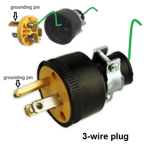

I understand that, most AC operated equipment has 2-wire polarized plugs. I was asking about the wall receptacle that you put the plugs into. A 3-wire wall receptacle can accept 3-wire plugs that ground equipment if it has it, and can provide a ground for equipment that doesn't if a good cold water pipe ground isn't available.
