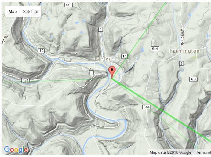

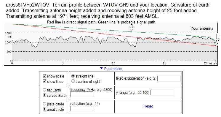

Are there any trees or buildings in the signal path from 44 deg magnetic for the second 751 for the 9s?
WTOV is a lot weaker than WTRF. I think a preamp might help.
If that doesn't work, then the antenna outside and higher.

rabbit73 5-Nov-2016 4:25 PM
2 Attachment(s)
First try a preamp; then switch to a higher gain VHF-High antenna if necessary, like the MCM 30-2475 or 30-2476 with the front end tilted up to catch the signal coming down from the crest of the hill.

rabbit73 6-Nov-2016 1:26 AM
Thanks for the report of your experiments. Rough terrain can do weird things to a signal.
It's even more odd because WTOV is only transmitting horizontal polarization. Some channels use horizontal and vertical polarization which results in elliptical polarization, IIRC.
