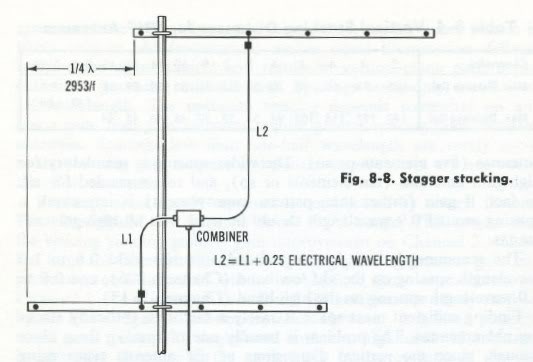

In order to receive channel 9 from Sacramento you will need to reduce the strength of the northern channel 9 more than the front to back ratio of your existing VHF Yagi. The cheap approach is to mount the antenna lower on the south side of your house to attempt to use the house as a barrier to the northern signal. The more sure fire solution is to mount a pair of identical VHF yagis 7' apart and carefully aimed to minimize the signal from the northern channel 9. To learn about stacking antennas to reduce interference, read the ganging section of the HDTVprimer.

I don't understand how the two-antenna trick can null KIXE co-channel interference because it is in the opposite direction.
http://www.hdtvprimer.com/antennas/ganging.html
I think it would take stagger stacking to improve the F/B ratio.
http://forum.tvfool.com/attachment.p...1&d=1476584907

I suggested horizontal stacking because KIXE is 21 degrees off the back of the antenna. When set at 7' spacing the first null occurs 21 degrees off the front of the antenna plus 21 degrees off the back of the antenna. Stagger stacking would work, but it's a bit more complicated than horizontal stacking.
rabbit73 16-Oct-2016 2:18 PM
Ah, so; a null is also created at the back.
Thank you.

Yes. So here's a true story. In the late 70's I installed a translator in Utica, NY. It retransmitted WNYT on channel 13 from Albany. There was also a channel 13 in Rochester, NY that was 14 degrees off the back of the antenna. The terrain toward Richester was more favorable than the terrain toward Albany. When testing reception with a 10 element yagi Albany was noisy and showed cochannel interference. When aimed at Rochester the audio was fine but the picture was not there. By ganging 4 yagis; two with horizontal stacking and two offset using stagger stacking, the picture from Albany was perfect.
rabbit73 16-Oct-2016 4:13 PM
Interesting story. Sometimes extreme measures are required to make it work.
How was the quad arranged and combined, the staggered pair in the center and the horizontal pair one each side like this +?
All-coax stacking harness or an air dielectric power divider?
Tower Guy 16-Oct-2016 4:32 PM
It was a box of four yagis. The top two were mounted forward by a quarter wave. The bottom two were centered. Both pairs were stacked horizontally by the critical distance for a 14 degree null. To aim them I looked at the lower pair on a TV set and nulled the interference. Next I connected the top pair using a extra quarter wavelength of RG-11 coax prior to the tee connector. The antennas were 10 element yagis made by Taco, which are still available from Wade in Canada.
