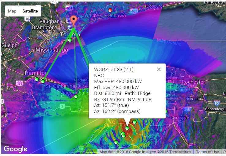

You are on the fringe for WGRZ
http://forum.tvfool.com/attachment.p...1&d=1474052469
BUT your postal code is in the blue, which is promising

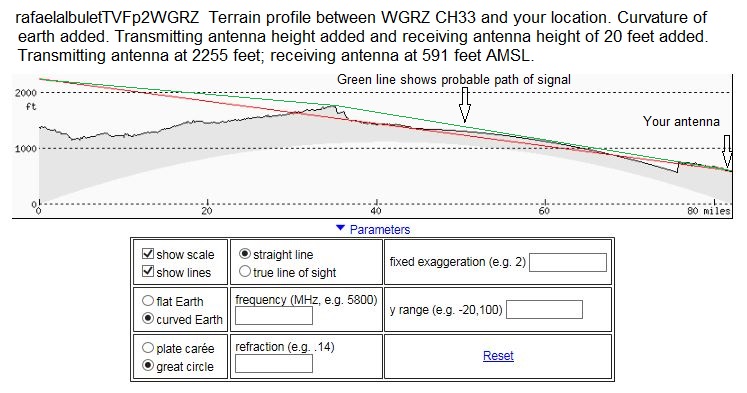

1 Attachment(s)
This is what the WGRZ terrain profile looks like, showing the curvature of the earth. You can also see how the signal skims the surface just before your location, so any extra antenna height should help especially if there are trees in the signal path.
http://forum.tvfool.com/attachment.p...1&d=1474055565
