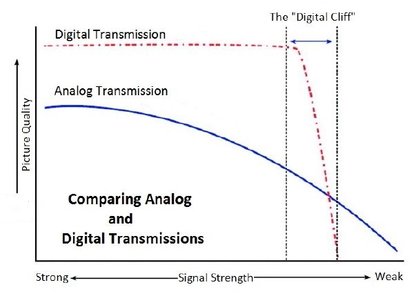

Digital TV signals are pretty much all or nothing, but there is a small zone between the two called the "Digital Cliff" where you will experience pixilation and picture freeze.
http://forum.tvfool.com/attachment.p...7&d=1465958114
