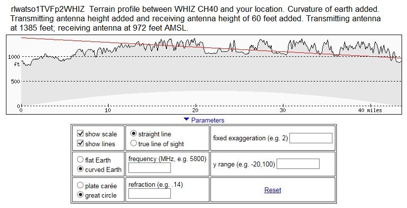

1 Attachment(s)

WHIZ might give you NBC
http://www.rabbitears.info/market.ph...&callsign=WHIZ

There is a lot of terrain in the signal path from WHIZ, but maybe some signal can make it to your location.
http://forum.tvfool.com/attachment.p...1&d=1457031974
