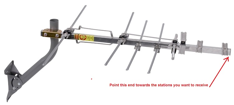

Ant-751
will it have instructions, etc that will show me how to point it to a certain degree?......keep in mind that I'm new at all this stuff....Thanks

Use a magnetic compass to aim the antenna towards the stations as show in the attached picture. You can find an inexpensive compass at Wal-Mart or stores that sell camping gear.Attachment 1726
