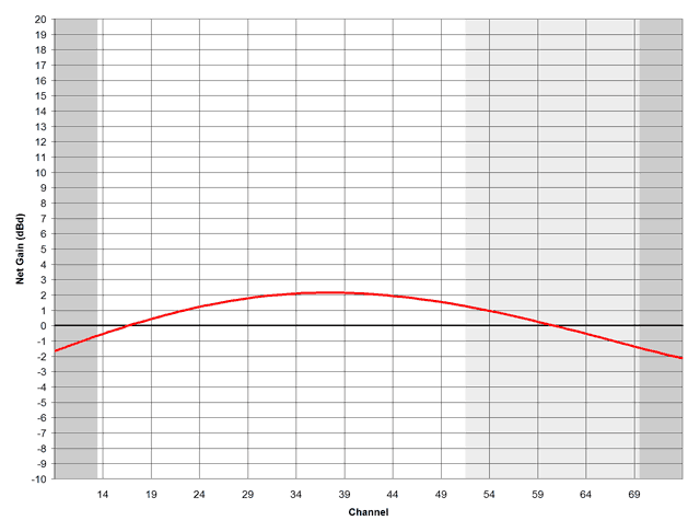

Have you tried adjusting the dial on the base of your antenna? These dials on rabbit-ear + loop antennas are usually there to manually "tune" the loop portion of the antenna (the part that deals with UHF channels). According to the product description for your antenna, this 6-position switch should allow you to adjust the antenna slightly.
If you look at the example gain chart for a loop antenna below, each position of the dial on your antenna should cause the peak of the curve to move to a different channel. If you can find a position that optimizes the gain on channel 36, you might be able to stabilize KSKN (just try all 6 positions until you find the one or two positions that work best).
Typical gain for a generic loop antenna
http://forum.tvfool.com/attachment.p...2&d=1260554610
