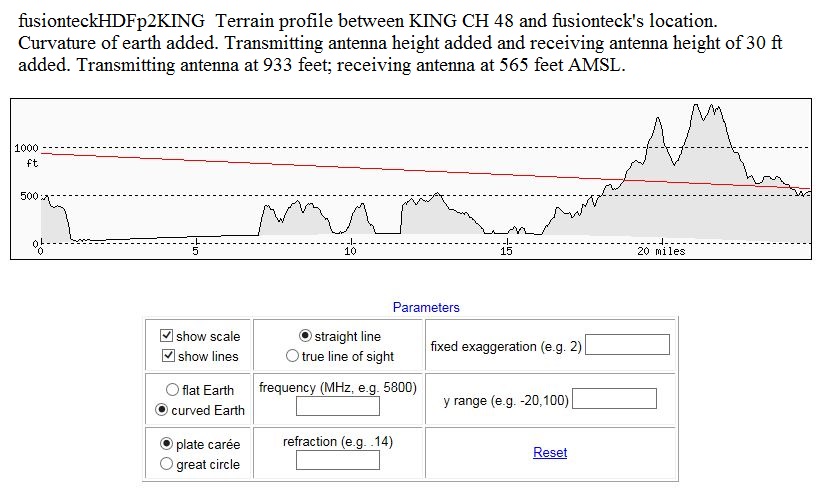

Terrain profiles for KING:
http://forum.tvfool.com/attachment.p...5&d=1443016059
http://forum.tvfool.com/attachment.p...6&d=1443016126
And here is the coverage map; not much signal at the fringe:
http://forum.tvfool.com/attachment.p...7&d=1443016159
The results for KOMO and KIRO are similar.
