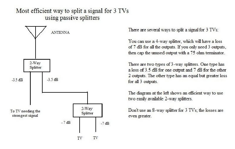

That would work, but keep in mind that a 4 output DA of either brand has less gain than a 2 output DA.
If you are going to feed 3 TVs and one coax line is much longer than the other two, you can do it like this:
http://forum.tvfool.com/attachment.p...9&d=1443470855
The diagram shows using two passive splitters, but you can replace the first passive splitter with a 2 output Distribution Amp.
