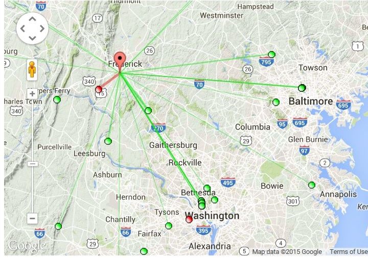

Hi - I cut cable awhile ago but would like to watch some live sports. Below is my report. I would appreciate and recommendations on antenna options. I'm split between the Baltimore and DC markets so any suggestions regarding which direction I would most likely get more channels would also be a great help. Thanks!

Welcome to the forum, gopixiego:
http://forum.tvfool.com/attachment.p...3&d=1441478033
Where are you able to put the antenna and why at 8 ft?
Any trees or other buildings in the signal path?
Washington looks a little better than Baltimore, but they both have 2Edge signals from terrain interference with the antenna at 8 ft.
It's kind of a toss-up because the weakest channels are from Baltimore but if you aim for Washington, WFPT might overload the preamp.
You are going to need a high gain VHF/UHF combo antenna like the Winegard HD7697P or 7698 and a preamp like the Channel Master 7778.
Any particular network you favor for sports?
