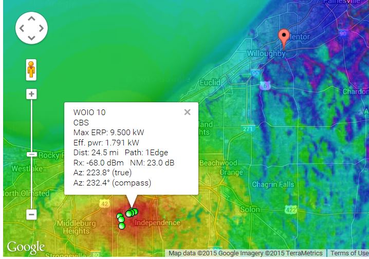

Your signals aren't very strong, so it's no surprise that you aren't getting many channels. You would need an outdoor antenna, mounted high, without trees or other buildings in the signal path. I see a lot of trees in your area; see attachment 1.
The WOIO signal barely makes it to your area. Notice only about 20 percent of the 9.5 kW signal is sent in your direction.
http://forum.tvfool.com/attachment.p...1&d=1439165387
