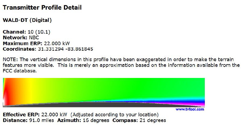

I am particularly interested in WALB and WFXL in Albany Georgia.
I don't think you will have much luck with them because they are very weak Tropo signals subject the whims of the weather, and they are blocked by the curvature of the earth that begins to affect signals at about 70 miles. If you click on a callsign in your TVFOOL report, you will see the terrain profile between the transmitter at the left and your location at the right. That black arc at the bottom of the profile is the earth.
http://forum.tvfool.com/attachment.p...1&d=1436817767
The only solution I can think of is to have a friend in Albany stream it to you over the internet with a Slingbox.
