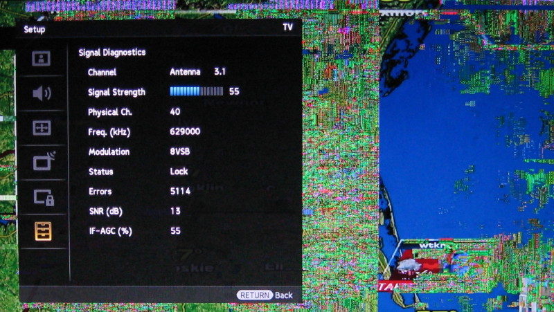

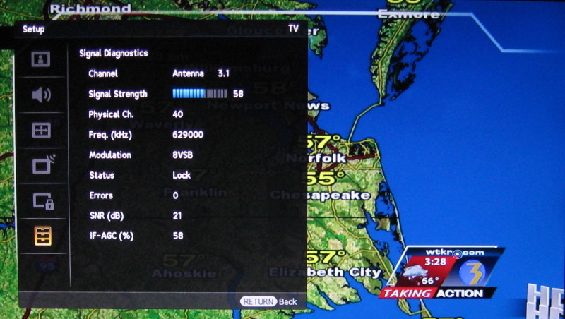

I have not tried the antenna on another TV. I only have one TV, but I am considering buying another one. Which types or brands of TV's get better reception?
I have had good results with weak signals with my Sony TVs. I have a KDL22L5000, KDL32BX320, and a KDL32R400A. Each one has a tuner a little more sensitive than the previous one.
All three are able to add a channel after scan, and all three have a Diagnostics Screen that gives signal strength, SNR and Errors. SNR and Errors indicate signal quality, which is at least as important as signal strength with digital signals.
Sony KDL22L5000, bad signal:

Good signal:
http://forum.tvfool.com/attachment.p...1&d=1434044640

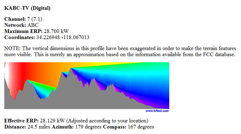

The signal path doesn't look very promising to me:
http://forum.tvfool.com/attachment.p...1&d=1434045454

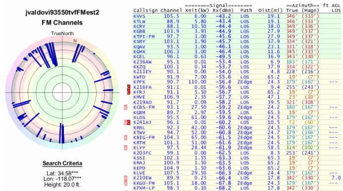

I don't have your exact address, but from an estimated address that gives a TVFOOL report very close to your report, an FMFOOL report doesn't indicate a threat from FM signals (but there are other types of interference that affect TV reception):
http://forum.tvfool.com/attachment.p...1&d=1434046187
TVFOOL report from estimated location:
http://www.tvfool.com/?option=com_wr...82306fb06476ac
I don't think you need an FM filter, but it's worth a test because they are inexpensive.
