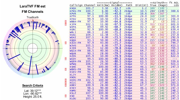

rabbit73 12-Jun-2015 12:11 AM
1 Attachment(s)
ADTech:
I did an FMFOOL report using short coordinates, and saw a strong FM signal. Please do one with exact coordinates.
http://forum.tvfool.com/attachment.p...1&d=1434067798
ADTech 12-Jun-2015 11:44 AM
Good catch.
Based on that, I'd also add an FM filter to the input of the preamp "just in case".
