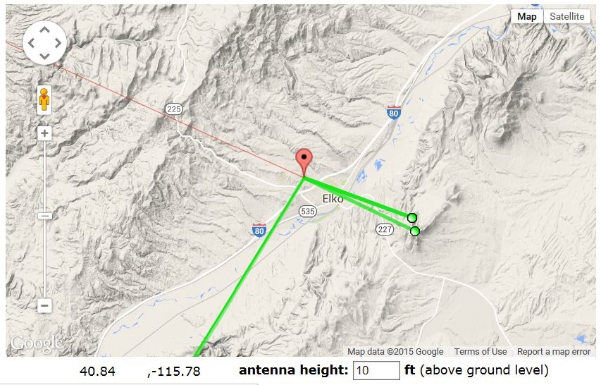

Hi, I have a Winegard Freevision antenna mounted on the platform that my satellite dish used to be on before I took it down. I have it pointed at some transmitters located LOS 4.7 miles away. I know it's pointed in the right direction because I can actually see the transmitting towers from my roof so it was easy to point the antenna. I am not using a preamp or a distribution amp. I have it connected to a passive two-way splitter that feeds two TV's. Judging from my TVFool report I didn't think I needed any kind of amp.
Anyway, I get very good reception on every one of the channels that transmit 4.7 miles from my house but one. It's channel 17 or virtual channel 11. It keeps pixelating on me. Sometimes it will be good for maybe an hour or two at a time, then suddenly it becomes virtually unwatchable for a while, then it gets good again. This happens during all weather conditions.
The thing I don't understand is this channel has better signal strength than several other channels that don't pixelate, according to my TV's signal strength meter. Channel 17 usually has a signal strength reading of 68. But some of the other channels go as low as the low 50's yet they never break up on me like 17 does. I can be sitting watching channel 17 and suddenly it will start to break up on me and I will check the signal strength meter and it's 68. Then I switch over to channel 36 and it is at 52 yet it's coming in just fine.
So I'm wondering if anyone has an idea what's going on and if there is anything I can do about it. All of these transmitters that I get except for one are translators rebroadcasting distant stations.
I'm wondering if perhaps this isn't a problem with my antenna and maybe it's a technical problem with the channel 17 transmitter or perhaps with the fiber optic cable that feeds it. Thanks for your help.

rabbit73 4-Jun-2015 7:20 PM
2 Attachment(s)
I wanted to look at your FM signals to see if they might be causing interference to your TV reception. I made an estimate of your location for a tvfool report that seemed to match yours:
http://www.tvfool.com/?option=com_wr...f1f071e1da6fc9
and I used that location to generate an FM FOOL report. See the attachment.
Multi-path is, by far, the most common type encountered. Small, not very directional antennas like the one you have are most susceptible to this issue.
I agree with ADTech. A more directional antenna might help.
Channel 17 is not on that tower, it's on a tower at 5.0 miles away at a different azimuth. With an antenna that isn't very directional, it probably wouldn't make any difference, but what could it hurt to rotate it a little to the right? You could try a more directional antenna like the RCA ANT751.
There is a good chance that you are getting a reflected signal of CH 17 off the ridge at the rear of the antenna that is causing interference to the direct signal. An antenna with a good Front-to-Back ratio might help.
http://forum.tvfool.com/attachment.p...1&d=1433445487
There is also the possibility of FM interference. Your strongest FM signal is KRJC with a strength of -16.8 dBm. It wouldn't cost much to insert an FM filter in the RG6 coax line as a test, but it would knock out real CH 6.
Is your coax grounded?
