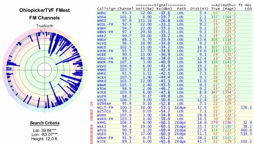

1 Attachment(s)
So some of my stations are VHF?
No, they are all UHF, until you get down to WGCT, real channel 8, which is an independent religious station. It is weaker than your strongest stations. If you want it, you would need a Winegard 7694P antenna instead in the attic.
I was able to click on the link and it opened the chart for Grove City Ohio.
Is that good or bad? Are you there, or someplace else?
Your tvfool report puts you near the Buckeye Grove Shopping Center and Quail Creek.
You have some strong FM signals, but they probably will not interfere with your TV reception. If they do, a simple filter (UVSJ or HLSJ) will help.
